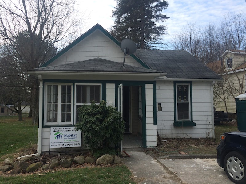

We believe the original part of the house is a 14×22 box. Bedrooms were added on the right side and a lean-to structure was put on the back for the kitchen and bathroom. Rough scale drawings on graph paper are part of every audit; below is my rudimentary drawing of the attic. Each box is 2 feet by 2 feet to scale. Note: this is not a blueprint, just an initial vision for the project. In fact, plans have already changed several times since this drawing.
Judging by the gas lines for gas lights, the first part of this home dates to between 1890 and 191,0 which disagrees with the county records that say 1940. Apparently there was a fire in the county records office about that time.

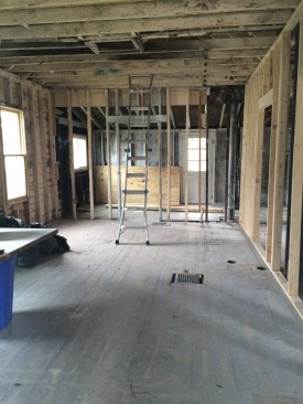

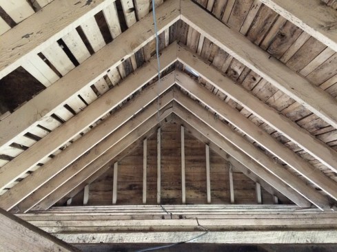

Since the interior had been gutted, it laid bare the opportunity for the original part of the house to have a 13-foot cathedralized ceiling, which will make a small space much more interesting and pleasant. Below is a view above the rafters and then a view from the front door. The Property Brothers would call it open concept.
The house looks tiny from the outside, but when you walk in under the very high ceiling, it feels HUGE. It reminded me of the tents in Harry Potter, which looked small but lived like a house inside.

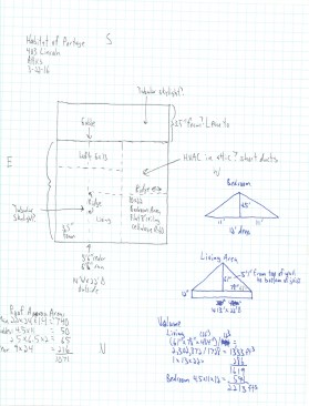

Scott and I both feel a cathedral design should be explored. If we can make it particularly pretty and unique, it’ll be much nicer for the homeowner and more suitable for public relations to show what is possible when you are willing to stretch thinking beyond the box. Naturally, this won’t be possible for most Habitat homes, but makes for an interesting case study.
Now I have to figure out how to make a Harry Potter tent out of this 720-square-foot ranch. It’s called a “jewel box” treatment: making small homes live large. Normally this is very difficult within a Habitat for Humanity budget. In the case of this particular house, it just might work. We both started giggling like 8-year-old girls thinking about how cool it could be. This is just the kind of project we both enjoy–fun and pushing the boundaries a bit.

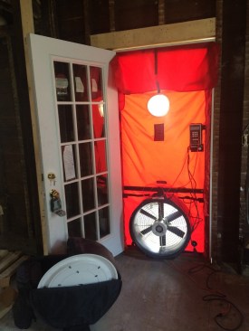

This house was leaky before. After being gutted, it makes a sieve look tight! Part of every job is measuring air leakage, which we do with a blower door:

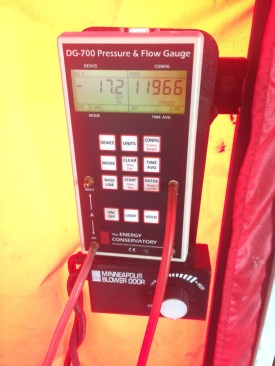

For reference, I consider a house decent when it has a blower-door leakage number roughly equal to its square footage. This house is 720 square feet plus 1/4 basement, 3/4 crawl. If it was a normal project, I’d like a target in the 700 range (that’s a back of napkin B or B- for leakage.) Houses are pretty bad when their leakage is double square footage (2:1). At 3:1 it’s horrific. Here’s how this one started:
Yeah, at 12,000 or 16.7:1, we have some work to do. Keep in mind it’s gutted, so we’re pulling from everywhere–leaks in the walls, roof vents, exterior basement stairway, and so on. My guess is the real number was closer to 2,500, which is still abysmal. There’s a reason older homes are known as drafty.
Lots of air leakage generally translates to a very uncomfortable house because outside air leaks in all over the place. Tighter homes are much easier to control because it is much harder for outside air to come in and turn your feet to ice cubes. (Check out my article on blower-door readings to understand more.)
Anyway, this initial leakage number is so high that it’s impossible to understand where the leaks are and practically meaningless, but at least it’s a starting point. Now to set some leakage goals. I have chosen the extremely difficult Passive House standard as my target for leakage. So my target is 110 cfm50 down from 12,000.

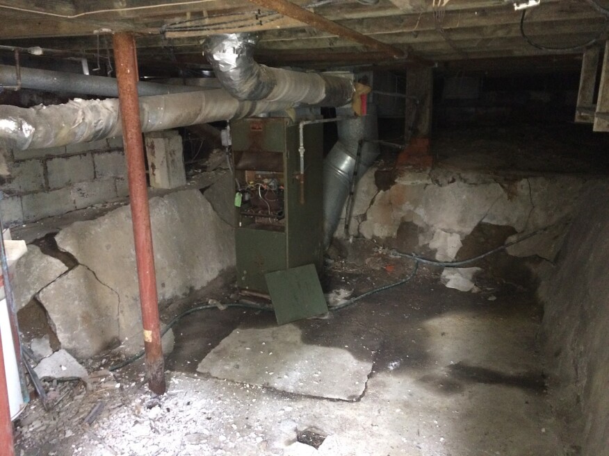

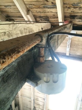

Next we headed for the basement. It’s actually a cellar with a 6-foot ceiling, and only in about a quarter of the house. The furnace and water heater lived there, key parts of the comfort equation. The furnace and water heater had seen better days. They’re red tagged, meaning they were shut off by the gas company because they are hazardous. That’s ok, we plan to go all electric, so a gas water heater and furnace is not an ideal fit.
Before we continue, remember this home was purchased for its floor plan, not the basement.

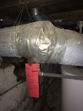

The ductwork was literally falling apart. There was a lot of plastic wrap on duct leaks, indicating previous uncomfortable occupants making a desperate attempt to send heat to the house rather than dumping it in the basement.
I didn’t get a good picture of it inside, but there were a lot of gaps in the foundation you could see light through. This tells me the basement and crawlspace are wildly leaky. These need to be addressed for both air and water leakage. Here’s a picture from the outside, note the missing mortar in a few vertical joints. This condition exists everywhere.

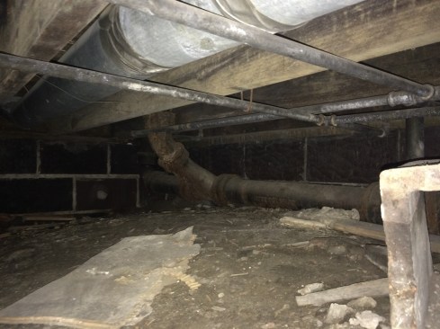

Yep. That’s a dirt crawlspace. It’s under three-quarters of the house. The other quarter, the cellar, has a little concrete but is not very dry. So now let’s check under the roof.

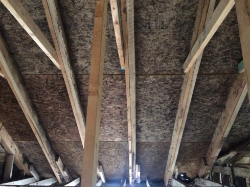

Sadly, most of the roof deck is covered with mold–even some of the old wood, which is more mold resistant. This is certainly a solvable issue; however it complicates the solution package somewhat.
The damp crawlspace and rough roof deck are health and durability issues. A damp building with rotting roof deck. Damp buildings were causally connected to childhood asthma in 2015. That’s a big deal. Even scientists don’t have a good grasp on exactly why wet buildings are bad, we just know they are. Moisture management is something that has to be dealt with by any plan we devise. While this house has above-average issues because of the crawlspace, moisture problems are shockingly common. We always consider moisture management in our designs.
Once the house is tightened, moisture is more likely to stay inside because it can’t leak outside anymore through cracks. High humidity is bad for a number of reasons; I’ve written about it here. With the ridiculously low leakage target I set, moisture control could be a 12-month issue. We will automate humidity management and plan to have monitoring of both humidity and indoor air quality because of the desired tightness of this house. Foobot has already stepped up with a free Indoor Air Quality monitor for dust and chemicals. Moisture and IAQ are pretty good sized complications, which we’ll talk about in the next article. (We also include IAQ solutions in every set of plans we create, typically in more costly packages.)

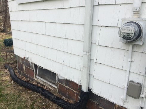

The biggest thing to look for is drainage: Does the ground slope away from the house so water wants to go somewhere else? Do the drains get at least 6 feet away from the house? In the case of this house, we’re in good shape. All the drains get away from the house and the house is at the top of a small hill.
Note how the drain gets behind the house and how it goes downhill. This is good. The other drains were the same way.

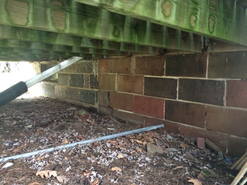

The holes in the foundation I mentioned are a big concern, but one that’s hopefully easily resolved. They’ll need to be tuckpointed and we’ll need to find a way to deal with the moisture inside the basement and crawlspace. The liquid water that gets into the crawlspace turns to vapor as it warms up. Moisture in the air is lighter than the air itself, so it tends to rise. After evaporating it heads for the attic carried by air through plentiful air leakage pathways. If attic surfaces are below dew point temperatures (like a snow covered roof), the moisture condenses back to liquid, feeding mold and rotting the roof.

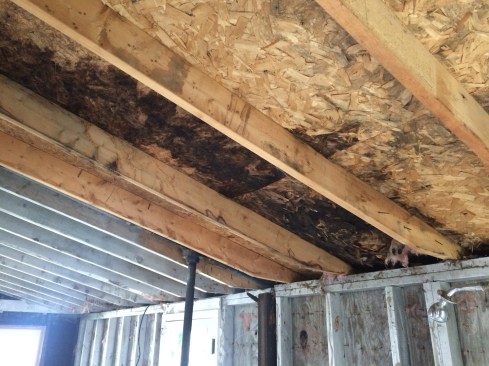

Nothing about this project seems to be easy. Our audit uncovered two major roof leaks. Check out the sheathing here above the original bathtub:
Black is bad. You don’t want to walk above this unless you are in a real hurry to see the basement. The house needs a new roof to deal with all of this rotted sheathing and the roof leaks. Thankfully, enough donated roofing material is available for replacing this roof.
