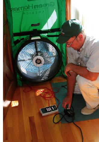

Blower-door testing. We use the blower door to measure the total air leakage of the house. If the house leaks too much, it costs too much to heat and cool. On the other hand, if it’s too tight, it may need mechanical ventilation for fresh air and will require direct-vented combustion equipment. Most houses we work on start out too leaky. So the “test-in” blower-door values provide us with a baseline; after we do our work, we’ll test again to make sure we accomplished the air-tightening we set out to achieve.
To run the test, the advisor shuts all the windows and doors, blocks off the fireplace, and installs his equipment in the door. He runs an air line from his manometer to the outside, then runs the blower-door fan and records the airflow required to bring the house to –50 pascals of pressure compared with outdoors. That number can be used to estimate the air-leakage area of the house envelope, which gives us an idea of how much air-sealing work will be needed.
The blower door gives you an aggregate airtightness number, but you still need to run around and locate the leaks, using smoke pencils. (The attic, by the way, is typically where most of the leaks are.)
