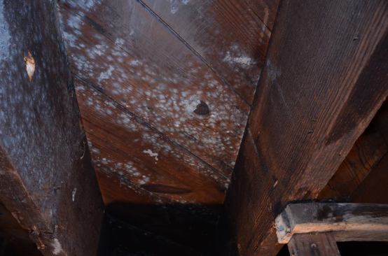

“We had to do a lot of talking with people to convince them that we needed to take out all the sheet rock two feet above the waterline,” Bennett says. “But people who did not have their homes gutted right away, once things were gutted — you know, it stayed moist here for a long time and in the worst homes that we’ve seen, we walk in and it looks like cotton candy growing off the wall.”

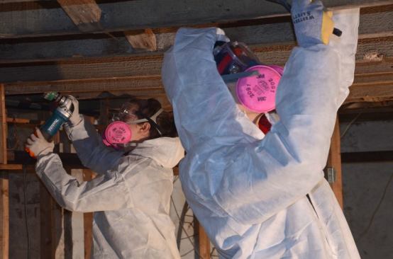

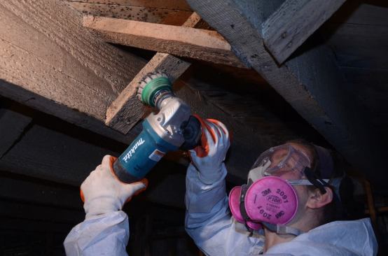

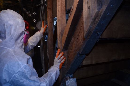

Next comes cleaning. “The actual remediation for the size houses that we are normally doing takes about three days,” says Bennett. “We use wire brushes and detergent. We brush down every bit of the structural wood that has to stay in the house. And we wipe everything down with detergent.” Respond & Rebuild uses a cleaning agent called Benefect (http://www.benefect.com), but Bennett says, “you can use a number of different kinds of detergents. Sometimes we use detergent mixed with Borax.” Once the building is thoroughly scrubbed and dried, it’s ready for reconstruction.
“We think the most effective method of mold remediation is also the cheapest and most accessible,” says Bennett. “But it’s just very labor-intensive — because scrubbing every single surface of the home with a wire brush is not fast. It’s not as fast as a fogger; it’s not as fast as a power-washer. But based on our research, it’s actually more effective than those methods.”
