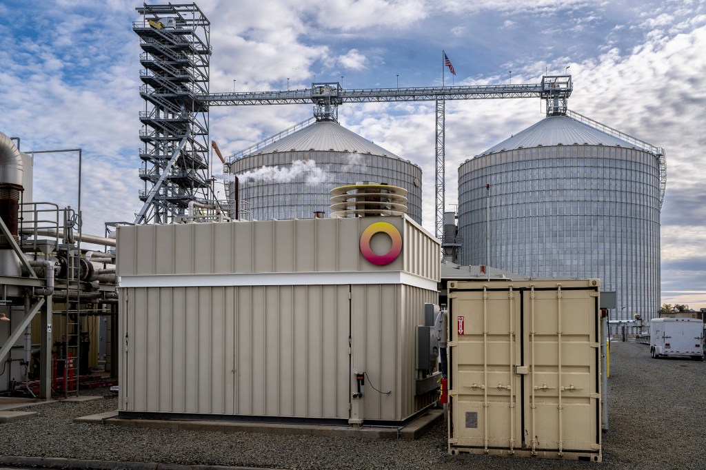

The 2 MWh Rondo heat battery at the Calgren ethanol plant in California.
courtesy Rondo Energy

Several companies have developed new technologies based on this approach. For example, Rondo Energy, based in Alameda, Calif., offers a heat battery made from bricks. The battery is a self-contained unit consisting of a stack of bricks and electrical heating elements that warm the modules via renewable power sources. The heaters raise the temperature of the bricks to 1,500 degrees Celsius, converting 100% of the renewable electricity into thermal energy. The bricks’ stored energy may be tapped through the delivery of forced air, which heats up to 1,000 degrees Celsius as it passes over the stack. This heated air is optimal for use in industrial processes ranging from cement and steel production to municipal infrastructure such as district heating or grid energy storage. As renewable power technologies become more capable and accessible, the heat battery represents a scalable solution to stabilize intermittent sources of renewable power and decarbonize many existing processes.

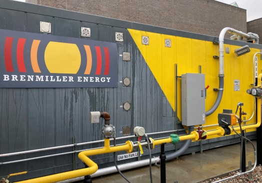

Brenmiller's bGen unit.
courtesy Brenmiller
Israel-based Brenmiller offers a similar approach, using crushed rock as its TES technology. Brenmiller’s so-called bGen unit is activated via renewable sources that are either electrical or thermal, such as flue-gas or biomass-based heat. The temperature of the volcanic rock increases to 750 degrees Celsius, and the heat is stored for current or delayed use. Compared with Rondo’s air-based strategy, bGen employs water as its heat-delivery vehicle, utilizing a system of pipes to circulate liquid around the hot rock—and eventually transform the water into steam. The unit is designed to maintain a constant steam supply for on-demand utility and industrial applications similar to those of the heat battery. In addition, Brenmiller’s technology can be deployed as a thermal power plant, as seen in existing projects for Italian energy company Enel, the New York Power Authority, and other partners.

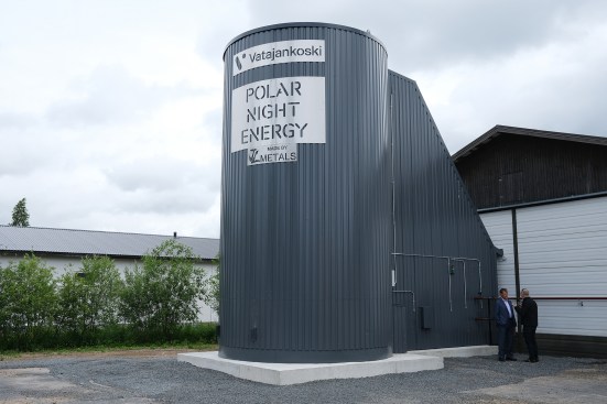

Another capable thermal storage material is sand. Finland-based Polar Night Energy has developed a sand battery as an energy reservoir for excess renewable power. The company claims to have installed the world’s first commercial sand battery in Kankaanpää, a town in Western Finland, as an integral part of a district heating network that includes commercial and residential uses. PNE’s first prototype is a 23-foot-tall enclosure containing 100 tons of sand, serving a community of 10,000 residents. The unit is sufficiently effective to mitigate seasonal differences in renewable power, as heat derived from solar cells during the summer may be stored for use during Finland’s long winter nights. PNE currently offers two products, a 300 MWh capacity unit and a 1000 MWh capacity unit, with the potential to develop larger capacity systems.
Polar Night Energy’s sand battery.
courtesy Polar Night Energy
