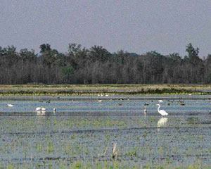

Smaller “postage stamp” wetlands are more difficult to restore, but there are many success stories. The key is to contract with a company that will work with the builder from “cradle to grave.” A living wetlands, such as this one shown nine months after restoration was completed, is not something that can be torn apart, rebuilt, and then turned loose to thrive on its own at the end of a construction cycle.
