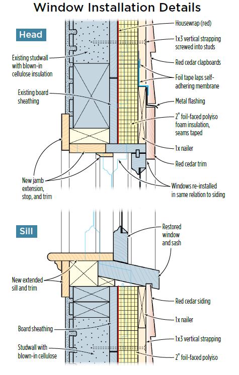

Reinstalling the windows. To match the original building façade, the restored windows were mounted flush with the furring strips. This required jamb extensions (top) and deeper sills (below) to accommodate the thicker wall.

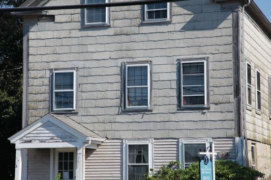

When WGBH took over the building in 2009, it was clad with asbestos shingles and the asphalt roof was failing. The walls and roof had little or no insulation, most of the exterior trim needed replacing, the two brick chimneys were crumbling, and the original double-hung windows were in poor condition. In short, the building had serious structural and energy-efficiency problems, as well as a lack of wheelchair accessibility. But its location within a historic district meant that any work done to the exterior of the building had to be approved by the local Historic Districts Commission.

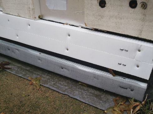

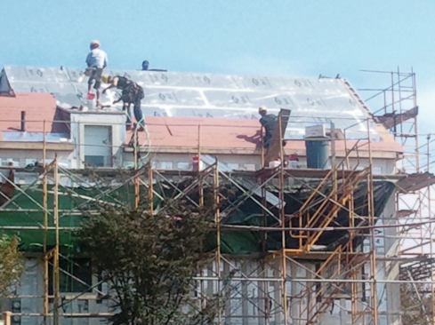

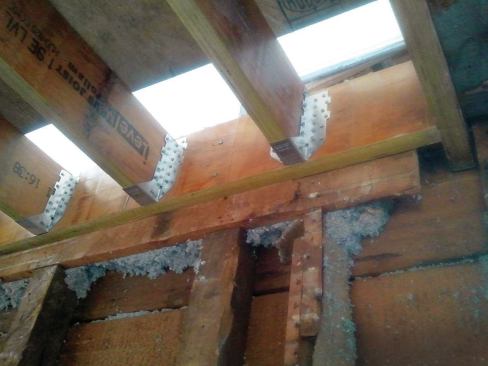

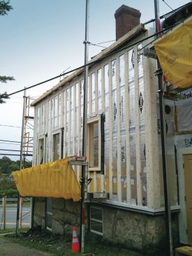

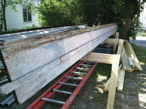

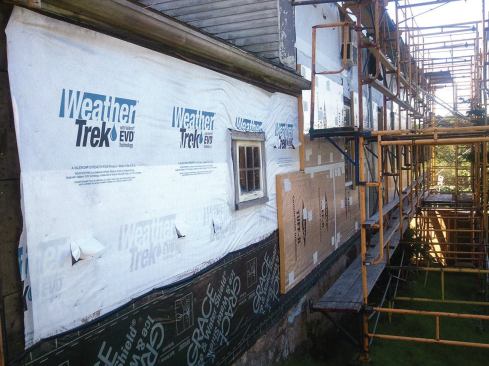

The Standards for Rehabilitation require that materials be repaired and reused wherever possible, so as the outer layers of the building were peeled back, we set aside any such material. Once the original board sheathing was exposed, we were able to fill the empty stud cavities and rafter bays with dense-packed cellulose insulation from the outside. Next we wrapped the walls and roof with a layer of 2-inch foil-faced polyisocyanurate foam insulation, taping the seams to complete the air and moisture barrier and provide a thermal boundary.
On the walls, we installed vertical strapping over the foam and put 1-by nailers around the windows and doors to serve as backing for the trim and siding. We added a strip of Cor-A-Vent (coravent.com) along the bottom and top of each wall to create a vented air space behind the new red cedar beveled siding. To attach the new red cedar roof, we screwed 5/8-inch Zip System (zipsystem.com) roof sheathing over the foam according to the manufacturer’s instructions, providing a continuous nail base for the shingles.

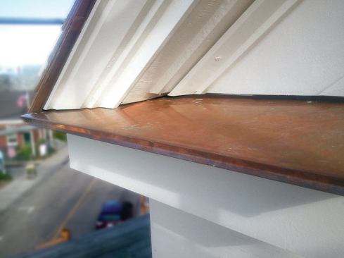

The extra layers of foam and nailers added about 5 1/2 inches to the overall width and length of the building and 2 1/2 inches to the height, changes that both commissions found acceptable as long as we faithfully reproduced the eaves, rake, and return details. The original trim on the building was cyprus, and we repaired and reused what was salvageable. We used red cedar for any replacement trim, a choice that was cost-effective and met the commissions’ requirements. (Neither synthetic trim nor non-wood siding was an acceptable option.)
One area where the commissions left no room for compromise was the windows. They insisted that we reuse every window deemed original. And they insisted that the windows be re-installed in the same relation to the siding as on the original building (see illustration). Therefore, all original windows were taken off site and painstakingly restored before being reinstalled. Non-original windows were replaced with new units that closely matched the originals. Though single-glazed, the restored windows were much more airtight than they had been previously, and interior storm panels improved their performance even more.
The only requirement the commissions had for inside the building was that we work within the Standards for Rehabilitation guidelines. We connected the three levels with a new code-compliant stairway and turned the walkout basement into usable space (see “Parking and Accessibility”). We also reinforced the structure with metal connectors where they were needed and added beams in strategic places.
