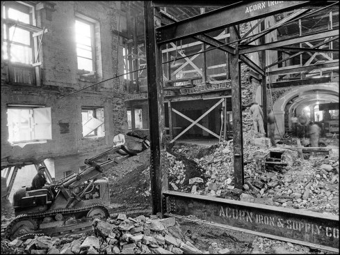

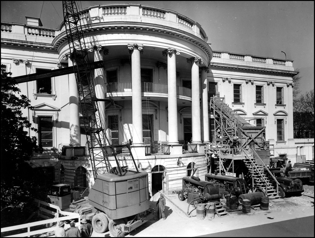

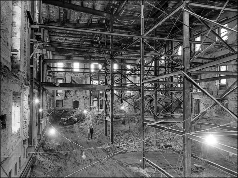

Demolition began in late 1949 without fanfare (perimeter fencing was used to hide construction from the public). Steel shoring and debris was passed through openings in the left-intact facade.
National Archives (Abbie Rowe, National Park Service). Feb. 27, 1950 Demolition began in late 1949 without fanfare (perimeter fencing was used to hide construction from the public). Steel shoring and debris was passed through openings in the left-intact facade.

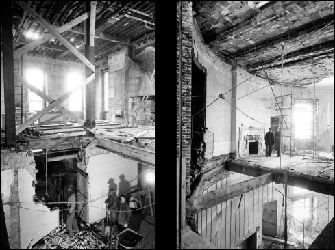

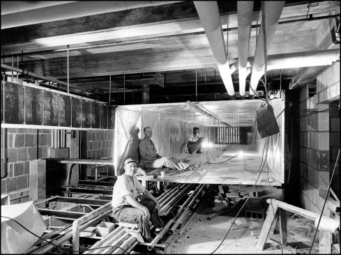

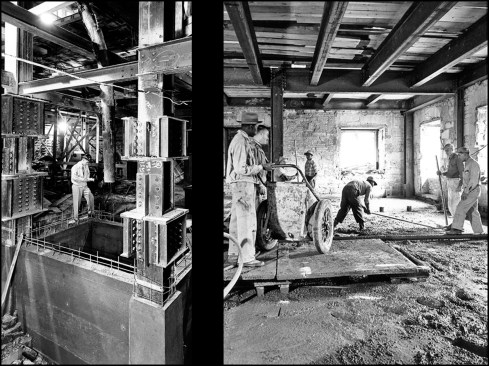

The restoration included leaving the historical structure’s facade intact, while completely gutting its interior. Within the remaining exterior shell, a steel superstructure “of skyscraper strength” was built above a new labyrinthine basement, which included a top-secret fallout shelter (the Soviet Union surprised the West by denoting its first atomic bomb in late summer 1949). The underground bunker’s “Cold War change order” as well as rising material and labor costs (the Korean War began in June 25, 1950, and put the U.S. economy in an inflationary period) led to schedule delays and further secrecy regarding the project (for more photos about the renovation, click on the slideshow “Truman's White House Renovation (1948 to 1952)”, left).
A good reference on this era is “The Hidden White House: Harry Truman and the Reconstruction of America’s Most Famous Residence” (St. Martin’s Press, 2013). In it, author Robert Klara sheds light on what may be the most complex and politically sensitive home-improvement project in American history.

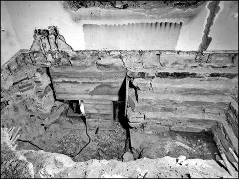

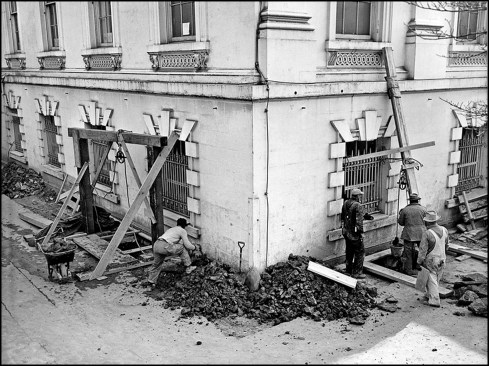

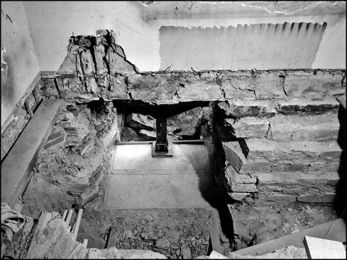

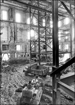

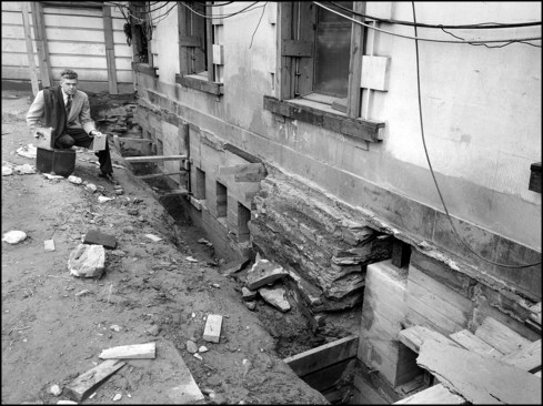

Klara notes that, “The logistics of construction were complex; it was described as needing to ‘balance a stone house in the sky’ while new foundations were dug beneath its walls.” Here, the mansion’s exterior walls were “underpinned” by new concrete piers and the interior was removed (the underpinning and steel shoring allowed earth-moving equipment to dig a new basement within the gutted shell). By mid-1950, roughly 1.1 million cubic feet of open space was created as a result.
National Archives (Abbie Rowe, National Park Service). May 17, 1950 Klara notes that, “The logistics of construction were complex; it was described as needing to ‘balance a stone house in the sky’ while new foundations were dug beneath its walls.” Here, the mansion’s exterior walls were “underpinned” by new concrete piers and the interior was removed (the underpinning and steel shoring allowed earth-moving equipment to dig a new basement within the gutted shell). By mid-1950, roughly 1.1 million cubic feet of open space was created as a result.
