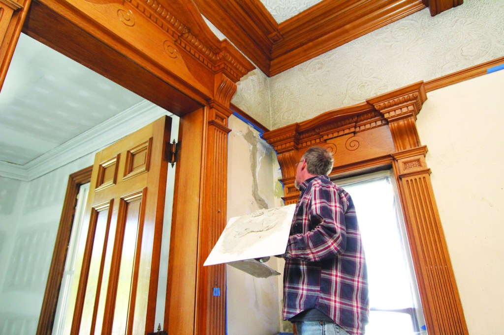

Ron Bisson applies brown coat to a textured wall using a putty knife and a trowel.
Pushing the brown coat hard against the old plaster helps key it in along the edge.

Working on historic buildings, we’re obligated to save as much of the existing plaster as possible and don’t remove stable plaster unless told otherwise. On this project, the architect mandated that we preserve as much of the existing swirled textured wall as we could. For us, the skill is knowing what plaster to remove and what to leave in place.
Starting out, we scraped out damaged areas until we reached sound plaster. Any plaster that had come loose from the lath or “lost its key” was removed. We then meticulously scraped out the gaps between the existing lath in order to key in the new plaster. Next, we cleaned the lath with a stiff brush and then vacuumed it off (vacuuming helps with the bonding agent application).

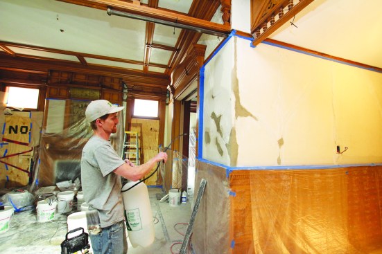

Bonding agent. Prior to mixing the scratch coat, we wet down the existing wood lath with a pump sprayer and brushed on the bonding agent. A bonding agent is used to help adhere new plaster to old, dusty lath. It’s basically made out of alum and it holds in moisture; we typically use USG’s Plaster Bonder. On older historical work, a bonding agent was often not used. On those projects, we’re therefore obligated not to use one. That means we have to be more conscious of dampening the lath—wetting it more frequently—which adds time to the plaster installation.

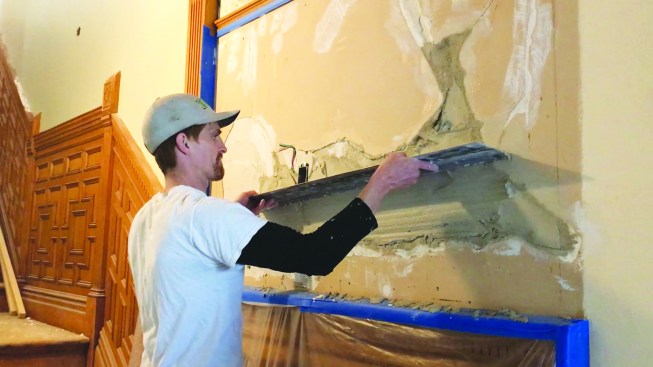

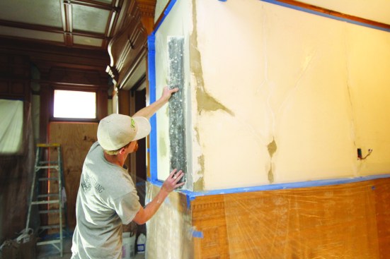

William Bisson applies brown coat to the damaged textured walls.

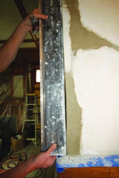

He uses a slicker to gauge the straightness of the brown coat at corners.
Brown coat. The brown coat is composed of water, gypsum, and sand. On this project, the plaster walls generally ranged from 7/8 inch to 1 1/8 inches thick. Plaster finish is usually fairly flat, but the underlying framing is typically not—plaster can therefore be very thick or thin in different locations on a wall. The brown coat helps to compensate for the variation in thickness and is applied to accommodate a 1/8-inch-thick lime-putty finish coat—the new finish is applied flush with the existing plaster finish.
We applied the brown coat with a 14-inch trowel and firmly pressed it into the scratch coat to flatten it out. Depending on the size of the repair area, we flattened and smoothed out the brown coat with darbies, slickers, trowels, or putty knives. We then allowed the two-coat base to set two or three days before applying the lime-putty finish coat.
Quick primer on plastering tools. On large repairs, we need to use a darby or a slicker to help flatten out the brown and finish coats. A darby is a 4-foot-long piece of metal that has two handles, one at each end. You hold one handle while you swing it around in an arc against the wall to flatten it. A slicker (or feathered edge) is a 42-inch-long metal straightedge that’s used to plane the brown and finish coats and square up corners. On mid-size repairs, we typically use 14-inch trowels to flatten out the base and finish coats. On cracks less than 2 inches wide, we use 6-inch broad putty knifes to flatten and smooth the plaster. We also use the knives to push the new plaster hard against the old plaster and help key it in along the edges of the repair, regardless of the repair size.
First he dampens the walls.

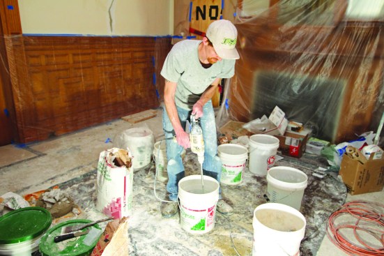

Then he mixes the finish coat.

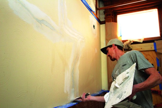

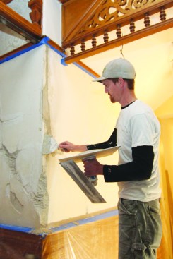

The finish coat is applied to the repaired area.
A 14-inch trowel and slicker are used and the texture is combed in.
Finish coat. The lime-putty coat consists of water, “slaked” lime, gauging, and a retarder—the lime being the bulk of the mix. On textured finishes, as was the case here, we add sand to the putty to texture it. “Slacked” lime is lime that has been soaked for a few days. Slacked lime is more pliable, and it blends into itself better. We store the wet lime in buckets and use it as needed. Plaster retarder is added to control how long you want a batch to last. But getting the mix right is tricky: Too much will weaken the plaster and it’ll crack; too little, and it’ll prematurely harden. Once we mix in the retarder, we add gauging to the lime. The gauging is highly refined gypsum and it serves as the hardener. We have about a 40-minute window to use the batch.

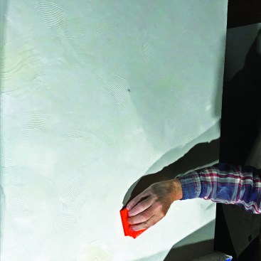

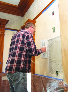

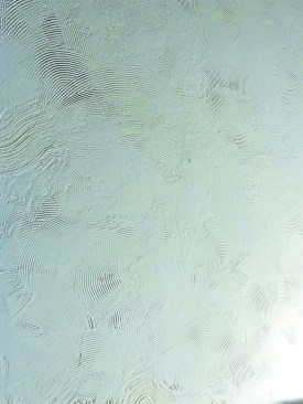

Ron Bisson uses a texture comb to mimic an existing swirl pattern.
With the lime putty mixed and the two-coat base coat wetted down, we applied the finish coat. Working in concert, William and I applied the textured finish coat. William put the putty coat on in two passes; the first pass was applied with pressure, the second, with little to no pressure. The second pass was loose enough for me to texture the wall with a plastic texture comb to match the wall’s existing swirl pattern. We needed to work fast, as we had only a five-to-10-minute window to start texturing the wall. The texture was fairly simple but difficult to mimic.
Feathering. Because the existing wall was painted and lime putty cannot adhere to paint, we had to feather our new finish coat right up to the edge of the painted surface. As we textured to match the existing wall, we wiped the plaster off the paint. After the lime putty dried, we applied parging (spackle) over the hairline seam between the new plaster and the existing painted surface and sanded it smooth to cover the seam.
