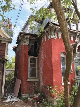

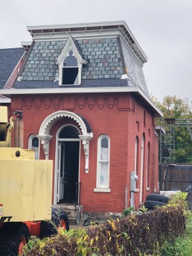

In October 2017, I received an email from Adirondack Architectural Heritage (AARCH) notifying its membership of the possible demolition of a building listed on the National Register of Historic Places. That caught my attention because it is uncommon to see National Register buildings demolished. (My wife and I are longtime members of AARCH, which provided assistance to us in the 1990s when we rehabbed Hubbard Hall, then a condemned building located in Elizabethtown, N.Y., and placed it on the National Register.) Locally known as Dr. Ferguson’s Office, this building was significant not only because it was on the National Register but because of its Second Empire style, interesting construction details, small scale, and overall charm. Unfortunately, it was near collapse.
Listed on the National Register of Historic Places, Dr. Ferguson's Office was built in 1870. By the time the author acquired the building in 2017, it was close to collapsing.
There was broad community support to save the building, including a local Facebook campaign, but the hour was late and no one had stepped forward. The City of Glens Falls, which had taken possession of the property in 2014 due to unpaid taxes, had solicited and received bids for demolition because of safety concerns. If my wife, Lisa, and I were going to act, we needed to move quickly.
I learned of the building’s plight on a Thursday, looked at it on Friday, and reached out to the town’s mayor about purchasing the property on the following Monday. He suggested I attend the next City Council meeting and make my pitch for purchasing. It was at that point that I started to second-guess myself, inspecting the building over and over again while trying to decide about moving forward with the purchase. On the one hand, it was in poor condition and needed a ton of work; on the other, it was on the National Register, small in scale, and within walking distance to downtown.
We decided to jump off the cliff and make our pitch to the council, which agreed to sell it to us for $1. This might sound like a good deal, but it was a negative asset because of its condition. Three days after our meeting, the city transferred title to us.

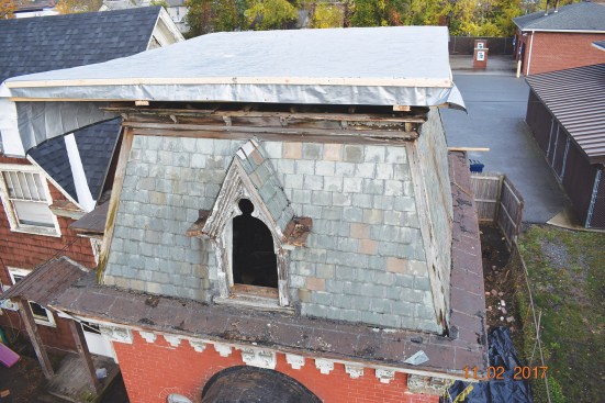

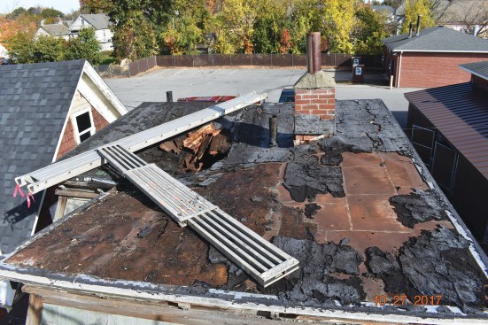

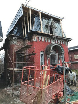

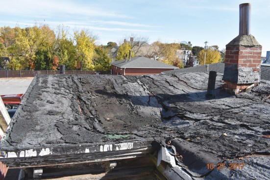

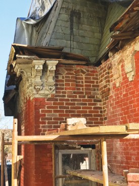

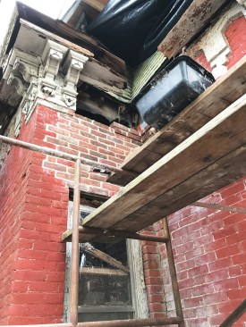

With winter fast approaching, the first order of business was to tackle the mansard roof to prevent it from collapsing and blowing out the walls. The original flat-seam metal roofing had failed, along with the built-up roofing over that, so the roof deck boards had rotted and created a funnel diverting water inside.
One of the building's most urgent problems was that the existing roof was funneling water into the building.
To buy time, the author covered the damaged roof with a temporary one framed with 2x10s, sheathed, and topped with a heavy tarp.
Temporary roof. Because repair work was needed on the exterior brick masonry walls before we could do anything about the existing roof framing, which was in worse shape than anticipated, I decided to install a temporary roof over the failing one. Even though the middle of the roof was badly deteriorated, I was able to install new temporary plates around the perimeter on top of the existing roof, then new 2×10 rafters on top of the plates. On top of the new framing and plywood roof deck, I installed a heavy-duty 16-mil tarp held in place with furring cleats secured to the fascia to keep the roof watertight over the winter. This detail worked well and was inexpensive, especially as we were able to reuse the framing materials in the permanent rebuild.
With winter looming in upstate New York's snowy climate, the author installed temporary 2-by bracing around the perimeter to help the roof support anticipated snow loads.

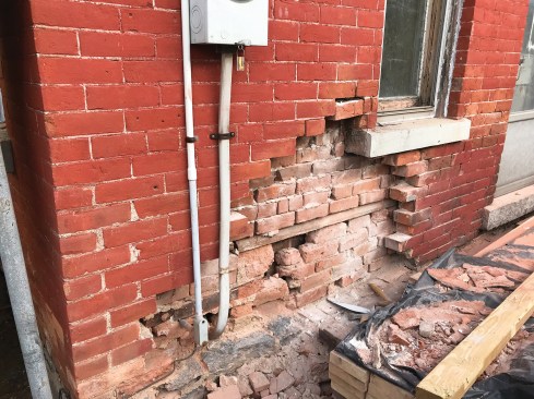

Brick masonry repairs. Then we rebuilt the exterior brick masonry walls that had caved in, salvaging and reusing existing brick as much as possible. This work needed to be completed before the roof work the following spring because the roof framing rested on the brick masonry.
The existing bricks measured a nonstandard average length of 7 3/4 inches (older bricks—called common bricks—are often a full 8 inches long; most new bricks—called modular bricks—are 7 5/8 inches long, a convenient length because with a 3/8-inch mortar joint, the combined length of one brick and one mortar joint is 8 inches).
With the building under protective cover, the author used a combination of salvaged and new modular brick to rebuild the portions of the walls that had collapsed.
To allow for movement and prevent the newly-repaired wall from damaging the existing wall, a low compressive strength mortar was used when laying up the replacement brick.
We matched the existing light mortar color by using white Portland cement instead of regular Portland cement, which is typically gray. Our recipe was 1 part white Portland, 1 part lime, and 6 parts washed sand, which is classified as a Type N mix. This relatively low compressive strength (750 psi) mortar flexes more than a higher compressive strength mortar, such as the commonly used Type S (1,800 psi), allowing for some movement and typically failing before the brick. Mortar is the sacrificial lamb.

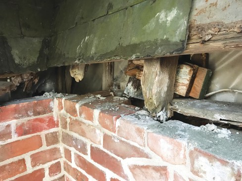

In places, the tops of the walls supporting the roof framing were single wythe…
…while the remainder of the walls were double wythe brick.
After we completed the needed exterior masonry work, we installed temporary vertical roof supports on top of the newly repaired masonry walls to stabilize the edges of the temporary roof. We anticipated a snowy winter and windy spring before we could tackle the roof repair work. As it turned out, we had above-average snowfall, but there were warm periods between the storms that melted the snow, and I only had to shovel off the roof once.

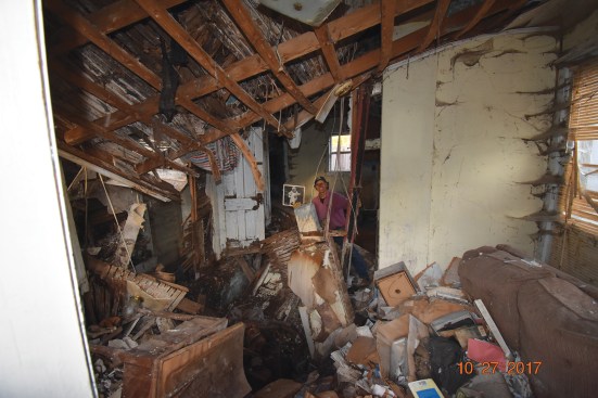

Meanwhile, our interior work continued over the dark and cold winter months, with weeks spent removing debris, old mechanicals and finishes, and damaged framing. In many ways, it is exponentially more difficult and time consuming to restore an old building that is in tough shape than to demolish and build new. And this building was in real tough shape, partially collapsed. I liken our work to a frame-off antique car restoration.
Original construction was wood lathe and plaster over brick. Interestingly, some walls were double wythe and some were single wythe, with wood framing backup. Nails driven into the exterior of the studs and left proud served as brick ties, but these ties had corroded and weren’t effective—in some cases, they had completely disintegrated. Some wood framing was rotted and had become compost. As a result, the masonry walls were bowing and looked like they were ready to come down with a strong wind gust.

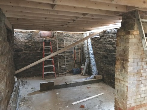

Surprisingly, the stone foundation walls proved to be in good shape and a full 8 feet high.
But virtually none of the existing framing could be salvaged, so most of it was rebuilt from the first floor up.

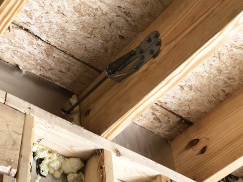

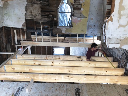

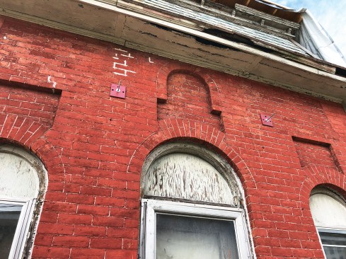

Second-floor deck framing. After installing a new beam to support the rear mansard roof rafters, we finished framing the second-story floor system with new joists bearing on top of the new interior walls. To prevent the masonry walls from spreading any further, we installed threaded rod and turnbuckle assemblies parallel to the floor joists. These consisted of Simpson Strong-Tie DTT2Z tension ties screwed to the ends of the floor joists and fitted with threaded rods that extend out to the exterior of the wall through holes drilled through the brick. Large plates acting as washers with nuts help distribute loads across the face of the brick wall.
To help reinforce the brickwork, the author installed tension ties screwed to the second-floor joists.
The tension ties are through-bolted to metal plates on the exterior of the masonry walls.

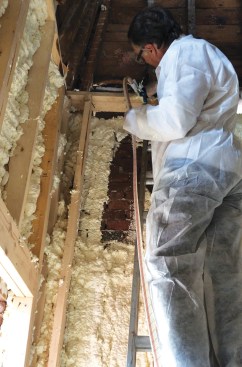

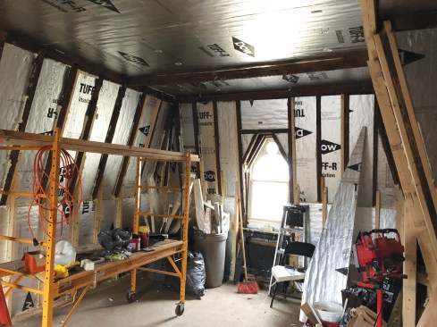

Insulation. We insulated the exterior-wall stud cavities with rigid polyiso foam, setting the board insulation in a bead of spray foam, then sealing the entire perimeter of the board to make an airtight seal. This helps to minimize water vapor transmission from the interior to the exterior during winter months. Vapor drive is always a concern with brick in our cold climate because the water vapor can condense, freeze, and damage the brick face.
The author used spray foam to insulate and reinforce the single-wythe brick walls.
We left an air space between the brick and the new rigid insulation, in part because the brick wall bowed out but also to create a ventilation channel between the brick and the foam. We sprayed foam insulation directly on the single-wythe wall, a unique detail that worked well to stabilize the wall.

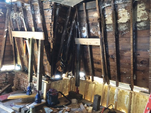

To bring the existing roof – which was as much as 7 inches out of level – back as close as he could to its original elevation, the author detached the rafters from the plates, then carefully jacked the existing roof framing up.
After repairing the roof framing, the author insulated the rafter bays and double-wythe walls with rigid foam. Joints between the foam sheets and framing were sealed with spray foam.

Framing fix. We shot reference elevations with a laser level and determined that portions of the roof had dropped as much as 7 inches. To correct this problem, we completely cut free the mansard roof framing from the wall top plate and jacked up the roof. We’ve jacked several structures over the years, including a boathouse that required diving and a three-story Victorian (which we moved one-third of a mile), but we had never separated a roof from a structure and jacked it independently. It was fun but a little nerve-wracking because the existing framing was in poor condition. We couldn’t trust it, so we reinforced the roof framing as best we could while still allowing the members to move back into their original positions.
An old structure moans when it is jacked. With every sound, our heads turned and eyes darted, looking for problems. Eventually, we made most of the roof structure level and settled on gaining back 5 1/2 inches out of the 7 inches in the worst area, deciding that jacking that area any more might be pushing our luck. (It’s wise to know when to stop, no matter what task.) This strategy saved us money and preserved functional historic materials.
Then we fastened new plates to the tops of the brick walls as needed using Tapcons. In some places, we had to cut new rafters to completely replace damaged framing, while in other places, we were able to sister on new framing to reinforce the existing rafters. Where the board sheathing was too far gone, we replaced it with plywood sheathing.

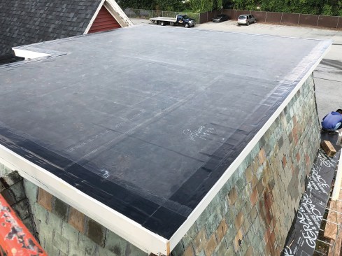

A new EPDM roof membrane was installed on the repaired flat roof.
After the roof was sheathed, we covered the flat portion with a .060 EPDM membrane. On the interior, we fit three layers of 2-inch polyisocyanurate rigid foam in the second-floor ceiling, sealed tightly to provide R-36, working as best we could with the space we had. Although current new-construction code for attics is R-49 in our climate zone, building rehabs are not necessarily required to comply with new-construction code. However, it is critically important to make the rehab of a historic building as energy efficient as possible. Care was taken to provide unobtrusive but adequate ventilation above the ceiling insulation, minimally affecting the building aesthetic. Holes were cored in the cornice and round, screened vents installed to provide ventilation above the rigid insulation.

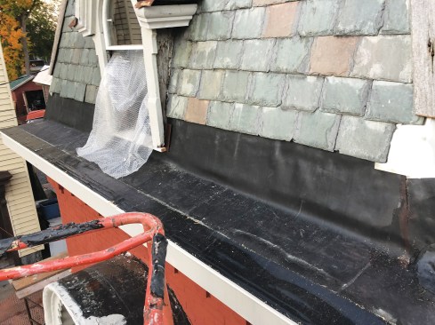

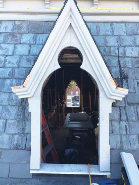

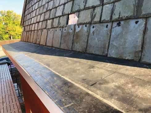

Slate. Because of the proximity to nearby slate quarries in Granville and neighboring Vermont, many old homes in the Glens Falls area were built with slate roofs. On this roof, the old slate on the steeply-pitched portion of the roof was thin and many of the joints had been tarred, making it difficult to repair the shingles in the traditional manner without breaking the remaining slate. Fortunately, we were able to source replacement slates from a local quarry that closely matched the originals.
After removing the lowest course of slate, the author installed an EPDM membrane at the intersection at the eaves.
Then the author replaced the lowest course of slate, surface-nailing the slate and caulking the nail heads.
Typically, to repair broken or missing slate, a special tool—called a slate ripper—is slid under the old slate to hook the old nails. The ripper is then yanked or hammered downward, removing both the nails and the slate. After a new slate is slid in place, it’s attached with slate hooks or by directly nailing through it in the space between the existing slates that cover the new piece. The exposed copper nail heads are subsequently flashed over, typically with small pieces (about 2 inches by 5 inches) of copper referred to by some old-timers as copper “babies.” The baby is twisted slightly out of plane and shoved with the head of the ripper under the top slates and over the nail, held in place by friction. Slate work is a specialty trade and can be fun, but this job wasn’t.
Because of our work to level and repair the roof framing, it was necessary to replace the bottom course of slate, which we surface-nailed. Then we caulked the nail heads with silicone and covered them with a copper flashing strip. This was a simple repair solution, effective and efficient.
A copper flashing strip was used to cover the repaired slate course.

Basement. After spending weeks early in the project removing debris, we were pleasantly surprised to find a concrete basement floor and tall, massive stone foundation walls in incredibly good shape. We hit the jackpot with these 8-foot-tall walls.
We decided to demo the existing concrete floor because it wasn’t level and was in poor condition. By doing so, we were able to add a 6-mil vapor barrier underneath the new slab, a critically important measure for controlling moisture in the building. Once we had the building envelope restored and weathertight, finishing up the project proceeded more or less conventionally.

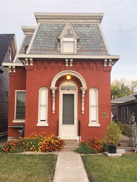

Why undertake a project like this if it’s more difficult than to tear down and build back? Natural resources can be conserved because of embodied energy in the existing materials. Preservation can be cost effective because of the initial low purchase price and use of sweat equity to create value, and historic tax credits can reduce project cost by 20% for residential and 40% for commercial rehabs.

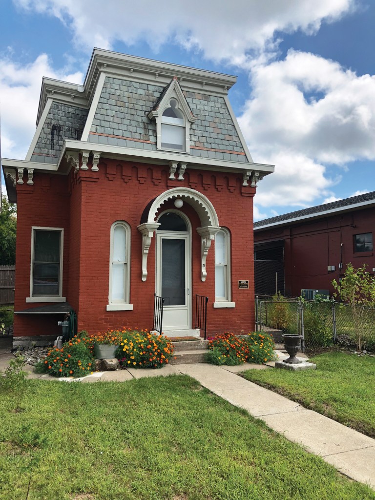

When the author started the project, the building was in dire condition, inside and out.

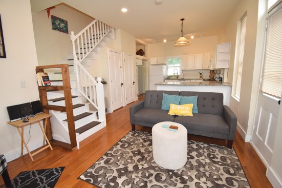

Once an eyesore, Dr. Ferguson’s Office has been transformed into an attractive rental property.
A project like this also has social value. Old buildings are part of the community fabric and provide a bridge from the past to the present and on to future generations. Unlike many other material objects in our lives, they are used regularly and can last a very long time if maintained. They provide a sense of time and place, reminding us of our mortality and fleeting time on this planet.
