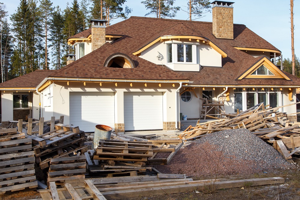

Eight thousand pounds of waste per average home construction. If that much recyclable material went into your home trash bin, you’d be up in arms, but after a long day, can you really be expected to care if a few leftover boards don’t find their way to the recycling center? After all, you’ve already helped an anxious homeowner choose between ivory and cream, driven to the hardware store (and then back again to get the correct size bits), and hauled half a ton of tile up two flights of stairs. Must you be responsible for the Earth’s fate too?
While exhaustion makes a pretty strong case here, the truth is that construction waste doesn’t just add up in terms of sheer volume. For businesses, reducing waste material isn’t a mere environmental issue—3M was able to save an estimated $500 million by implementing its reduction plan. With landfilling costs rising, your castoff pieces represent financial loss as well. You may not be a large manufacturer, but you can still benefit in a smaller way by using these tips to squeeze the most out of your materials.

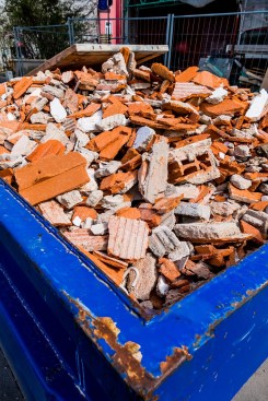

Use a C&D Debris Recycling Service
C&D recycling services say they rescue hundreds of tons of construction waste each year, so you can see how that can add up. Some companies may even provide sorting receptacles for you to use onsite, and will often offer free hauling for larger items. Meanwhile, reuse stores, such as those operated by Habitat for Humanity, will gladly accept donations of older whole pieces, such as counters, sinks, cabinets—even ceiling fans and plumbing fixtures can find a home there. Using these services will often give you points toward your LEED certification, as well.
Sort Salvage Materials Onsite
To save your hauling service time, they’ll usually ask that, at a bare minimum, you sort your debris into wood-only and metal-only piles before they come to pick it up, meaning that you’ll need to designate a location on the premises for this job. If you don’t happen to have a couple of metal bins handy though, think about investing in some sturdy bag Dumpsters instead. To really make a commitment to sorting, you’ll also want to build extra work hours into your project timeline before you even begin.
