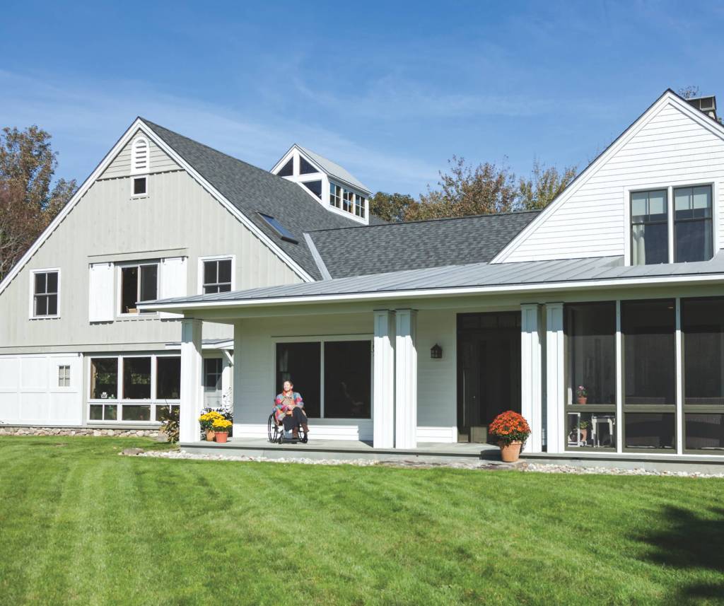

Siting the building close to grade creates a strong connection to the landscape. A no-step entry at the house’s driveway side provides wheelchair access.

Given the clients’ inclusive program, though, accessibility would be as important as style. Whitten devoted special attention to siting, even sacrificing some of the ocean view to keep the ground-floor spaces no more than a single step above grade. Alice, who had polio as a child, served as Whitten’s tutor in matters of wheelchair navigation.

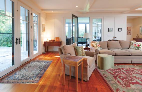

Wide passageways make for safe, comfortable circulation. Furniture groupings leave room for a wheelchair to complete the arrangement.

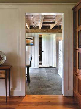

Wide doorways with zero thresholds meld seamlessly with the traditional architecture.

Mac and Sue contributed their own insights to the project. “I’m a physician,” Mac says, “so I’m familiar with people aging and their capabilities diminishing. It’s usually a fall that changes the level at which a person can function,” he says, “so we were conscious of designing the house for a person who has difficulty walking—and difficulties with vision too.” He and his wife, who worked for years in construction management, requested a first-floor master suite and no thresholds or elevation changes at the first floor.
Further easing circulation, the house’s public spaces are either open to each other or joined by doorways wide enough for two people to pass through simultaneously. Light switches are low enough for a child or a person using a wheelchair; door hardware consists of levers or egg-shaped knobs that are easy to operate. Furniture arrangements include space for a wheelchair to roll by or to join the grouping.

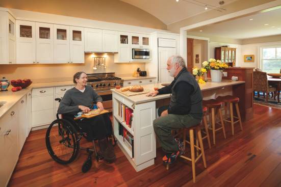

Age brings changes in vision and hearing too, Mac notes, “so there are enough lights in the ceiling—on dimmers—so that we can see.” Natural lighting is also abundant, with windows on two or three walls of most rooms. A large skylight tops the kitchen’s central work area, where clear vision is especially important. “There’s also a [centralized] sound system,” Mac says. “I’ve had a little hearing loss, and I can direct the sound of the TV through the speakers.” A home security system offers peace of mind on a site that can feel somewhat isolated on a winter night. “That’s something you think about as you get older,” Mac says.

Nine years after the move-in, Sue says that she and Mac don’t give a lot of thought to the accessibility aspect of their project. “It’s just great living in this house,” she says. “It doesn’t feel cavernous when we’re here alone, but we have room for 12 people to stay overnight. And when the house is full it’s really nice, especially when the weather is good and we can use the outdoor spaces.” Sue also has noticed how easily activity flows between indoors and outdoors, and she credits Whitten for siting the building close to the ground. “We have four outdoor areas that are used really heavily,” she says. “Our front yard, in particular, is really like a huge room. It’s only one step down from the front porch, and it’s used really intensely. We notice that’s not the case with the other houses in the neighborhood.”
The kitchen features wide aisles, plenty of natural light, and a island that permits seated meal preparation.
