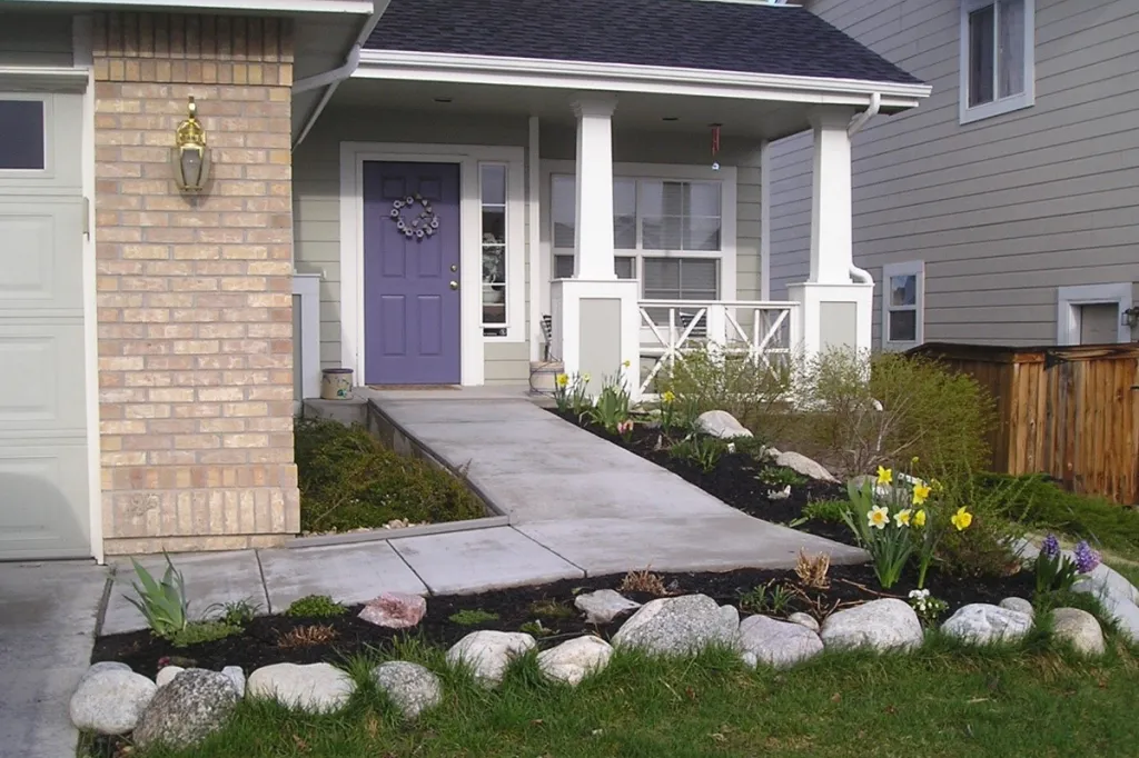

Walk with a friend side-by-side and measure how much room is needed for a walkway. You may be surprised and wonder why most walkways are only 24 inches to 36 inches. Be careful to make these surfaces smooth. If your grocery store shopping cart will stop when one wheel hits a tiny pebble, imagine using a wheelchair. Make the walkway smooth and free of bumps. Right-angle corners on a walkway can add a challenge, so recommend curves or wider areas at the corners. And if walkways are long, suggest creating rest areas off to the side.

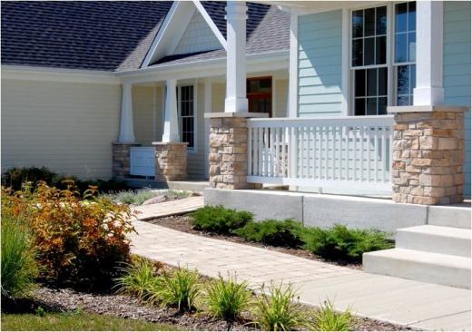

Ramps, when installed by professionals, look seamless as good design. If a ramp is installed, recommend a slope with less than an inch rise for 18 inches of length. Nathan Colburn, partner at Accessible Systems, suggests an alternative to ramps is a sloping walkway. Be sure there is proper lighting, rest areas, and turn areas of about 6 feet by 6 feet.
An ultra-low–profile ramp leading up to the front entrance is cleverly disguised by landscaping and a front porch.
Courtesy New American Homes
“We promote the use of concrete ramps with decorative iron railings,” says Stouffer. “They also incorporate steps accessing the front door landing for visitors who may not need to travel the length of the ramp. Add some landscaping for screening, and you have a durable ramp that blends right in with the home.”

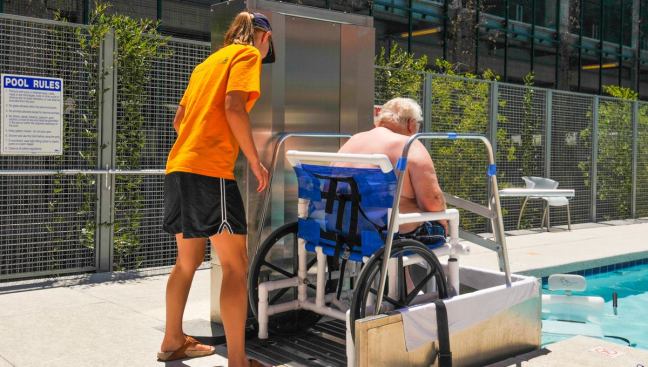

Pools present a greater challenge. Pool fence companies know how to reduce hazards. Child safety experts can be invaluable for understanding safety in playgrounds and pools. To make pools accessible for almost everyone, install a pool-side lift or a gradual sloping walkway into the water.
