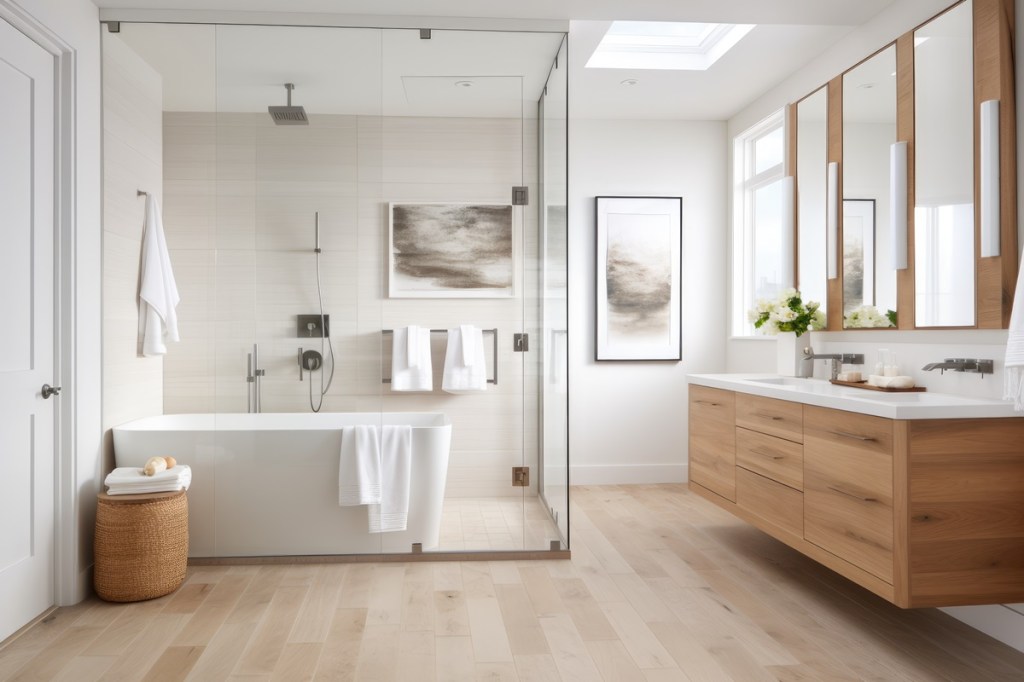

In the U.S., wet rooms typically combine a separate shower and a tub in the same area, allowing water from either element to be contained in one location, often behind a glass enclosure. A wet room can also be a bathroom with or without a tub in which the shower is open to the rest of the room.
What features do wet rooms have? How do they differ from just large showers?
Wet rooms often have a barrier-free entry to the shower. The flooring then has a slight gradient so water flows to the drain and not the rest of the bathroom. Bathroom remodelers recommend a gradient of 1.5 to 2 degrees for floor slope with square or linear drains. The floor needs a waterproof substrate beneath the tile. In a wet room, a larger wall area may need waterproofing compared with a large shower, and the walls are usually tiled from floor to ceiling. Wet rooms often combine a stand-alone tub and a shower area with multiple shower heads and sprays.

We’ve seen a variety of configurations in popular photos on Houzz, however wet rooms generally have a curbless or low-curb entry and a frameless glass pane or pony wall to separate them from the rest of the bathroom and contain splashes.
