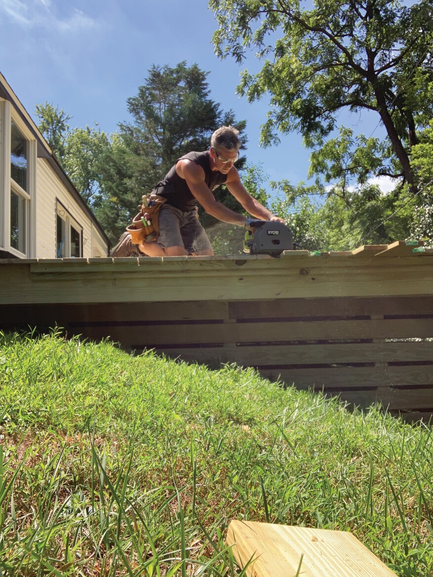

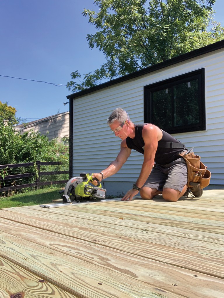

Performance. Having used the Ryobi track saw on several projects, including a couple of decks and an interior trim job, I’ve found that power is not this saw’s forte. However, if the only thing standing in its way is 32 feet of composite decking or a door that needs resizing—both of which I tested the saw on—it’s smooth sailing. I also used the Ryobi to trim the edges of a 16-foot-deep pressure treated deck, with great results (Ryobi claims that the saw can rip up to 260 lineal feet per charge). Sure, other saws have longer tracks, or longer battery life, or are corded, but for 16 feet? The Ryobi handled the job easily.
