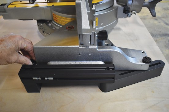

Setup. Referring to the easy-to-follow set-up video on the EZ‑Wings website, I spent about an hour screwing and bolting the miter-saw station together (the necessary fasteners for each step are clearly marked and packaged together). EZ-Wings uses an adjustable base system that attaches through the holes that are already in your particular saw. According to the manufacturer, Red House Tools, the system can be set up to work with just about any existing saw stand.

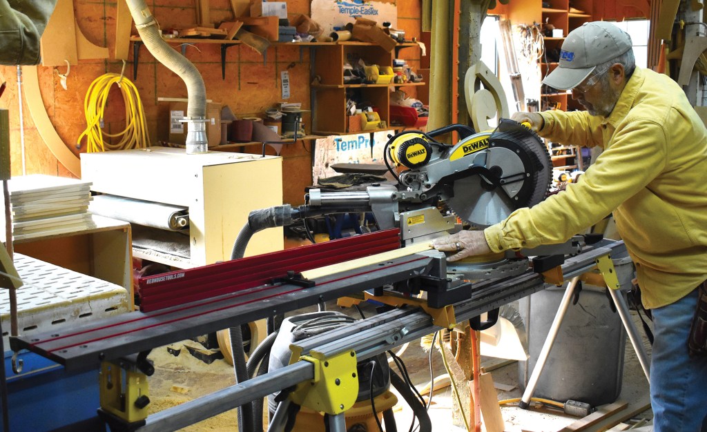

The EZ-Wings Pro miter saw station is compatible with most saw stands. The system’s support wings attach to a two-piece base, which adjusts to fit your saw.

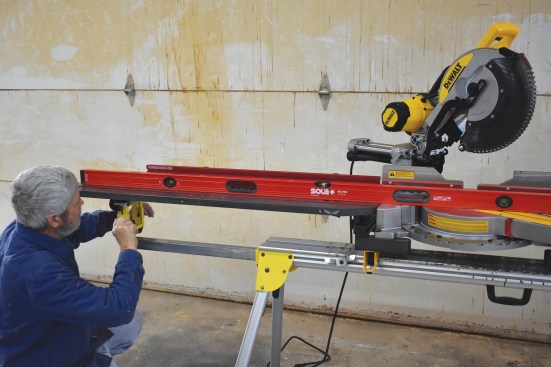

The mounting bracket that attaches the wings to the stand has front-to-back adjustment and another screw to micro-adjust the height to match your saw, plus a couple of bolts with comfortable grips for tightening the bracket after you make final adjustments.

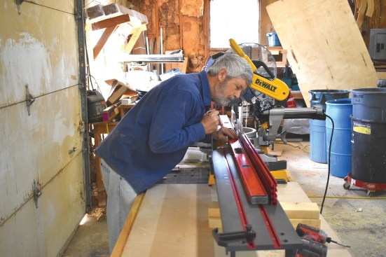

Multiple wings can be added to each side for additional support, while L-brackets are used to make the fence-to-wing attachments. The author recommends setting the EZ-Wings fences up about 1/4 inch behind the saw’s fence to accommodate material that isn’t perfectly straight.
Here the author is attaching the miter station to a DeWalt saw stand, using four 1/4-20 x 2 1/2-inch bolts (that is, 1/4-inch-diameter-by-2 1/2-inch-long bolts with 20 threads per inch)—the only bolts not supplied in the EZ-Wings hardware packet—to fasten the assembly to the base. A 6-foot level placed across the top of the saw table and wings while he’s adjusting the saw stand brackets helps the author to align the assembly.
All it takes to break the miter-saw station down is backing off one screw on each side to remove the wings. Because the wings attach to a bracket that remains fastened to the saw, their position is identical each time they are remounted, and the system stays aligned. For transport, all the components can be neatly packed in the equipment bag that comes with the system.

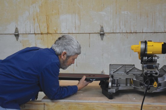

Performance. After sliding the stop in, I made some test cuts and was happy to see that the stop had no play in it at all. If I am trying to make a cut within 1/32 inch, the stop can’t move. Right now, Red House does not offer a built-in tape measure that works with the stop, but I am told that the company is working on several more measuring/stop options, including a laser measuring device.
