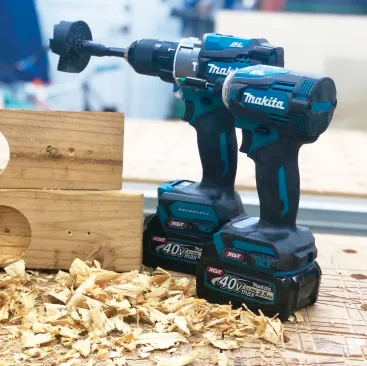

Makita’s GDT01 impact driver and GPH01 hammer driver-drill are both powered by the company’s new 40-volt XGT battery platform. The high-torque impact driver has four speeds and multiple modes to fine-tune the tool to the application, while the drill-driver has the power to drive large bits through thick stock.

The matching XGT 1/2-inch hammer driver-drill (GPH01) has three modes, two speeds, and 1,250 inch-pounds of torque. To switch modes, twist the dial just behind the all-metal keyless chuck: Mode 1 is a regular drill mode; mode 2 is hammer mode, suitable for drilling into masonry; and mode 3 is the electronic digital clutch mode. When you switch to mode 3, a small screen lights up at the base of the drill, displaying a number, which allows you to quickly and accurately dial in your exact torque setting—41 settings are available in low speed, and 21 in high speed—as you use the scroll wheel. Again, I had to refer to the user’s manual to figure out exactly what each number represented in torque settings, though this was easier to understand than the GDT01 impact driver settings. My favorite feature is the drill’s Active-Feedback sensing technology, which turns the motor off if rotation of the accessory is suddenly forced to stop.
The GPH01 feels a little heavy in the hand, even with the 2.5-Ah battery, and it’s also top heavy, so balancing this drill on an uneven surface is difficult. However, I did appreciate this weight when drilling horizontally, especially when using large-diameter self-feeding bits. With a 2 9/16-inch bit chucked in and the drill in speed setting 1, the GPH01 plunged through 2×4 pine with ease, showing me that it was made with torque in mind.

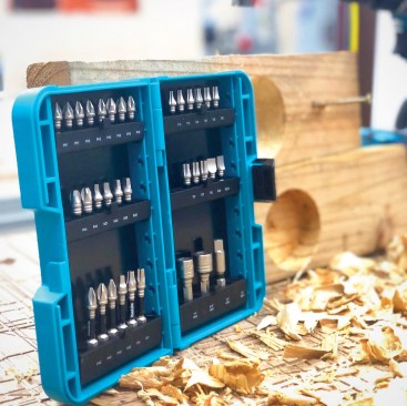

The author used Makita’s Impact XPS bits during testing, which the company says last much longer than standard bits thanks to the carbon alloy steel used in their construction.
