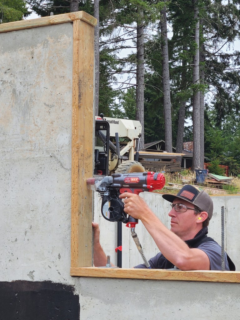

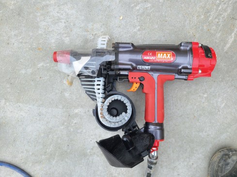

Designed for use with the Max 500-psi compressor, the Max HN120 PowerLite nailer shoots fasteners up to 2 1/2 inches long into both concrete and steel. The gun comes with different tips for different materials and has a coil magazine that holds up to 50 fasteners.
The Max HN120 will shoot nails into both concrete and steel, no powder charges needed. All that’s needed is the Max 500-psi compressor. The gun comes with the different tips needed to fasten metal track to both concrete and steel and to fasten wood to concrete and steel I-beams with fasteners up to 2 1/2 inches long. It’s a coil nailer—the magazine holds up to 50 nails—and it features the standard Max swivel fitting and air filter.
I’ll be honest—I was a little nervous at first about using the gun, even though it doesn’t require a license or powder loads to operate it. Max claims that the 6.4-pound gun shoots with 2,231 inch-pounds of driving force, so I was expecting a lot of recoil. After getting a little more familiar with its operation, I felt more comfortable using it and found that it was easier on my wrist than a powder-actuated gun. When shooting into concrete less than a year old (our typical job), I found no difference in fastener performance between this gun and our old Hilti.
This gun isn’t cheap at $991, but then again, the Max 500-psi system isn’t cheap either. A Hilti DX 460-MX gas-actuated fastening tool, which works with either single fasteners or collated strips of 10 fasteners, costs about $1,380. Since we’re already invested in the Max system, the HN120 gun is a no brainer for us. The fasteners we use with this gun cost about $0.10 each, while the Hilti runs $0.14 per fastener and $0.41 per powder cartridge. maxusacorp.com
