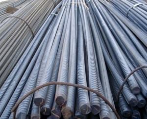

12 Things You Probably Don’t Know About Rebar
Your last truck, fridge, or microwave may have been turned into rebar at a plant close to home.
