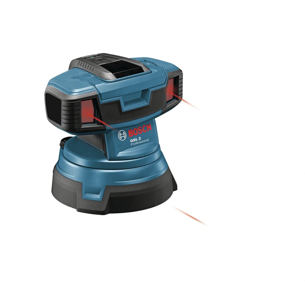

1. Bosch GSL2 Surface Laser
The GSL2 is unlike any other line laser we have seen. Lasers usually project plumb and level lines; the surface laser projects a pair of parallel angled lines onto the floor. The lines overlap to form a single fine line at an elevation set by the user. If there is a dip or rise in the floor, the lines will diverge, yielding a widened double line at that location. The farther apart the lines, the greater the dip or hump in the floor. An included protractor-like target allows you to measure the height of any variation found.
The GSL2 is self-leveling and rotates its lines in an effective radius of 60 feet with the help of its full-function remote. The tool is powered by either AA batteries or an optional Bosch 12-volt max rechargeable tool battery. This is the type of ingenious but simple tool that makes us wonder why no one thought of it sooner. Price: $549. 877-267-2499. boschtools.com.
