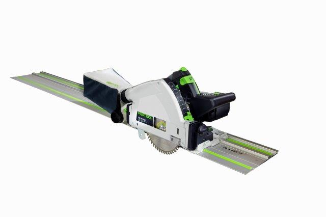

When Festool introduced a cordless version of that saw two years later, I was intrigued. The TSC 55 IMP. saw (which also goes by the number TSC 55 REB on the tool itself and in the 2016 print catalog), is typically powered by one or two 18V batteries that deliver 18 or 36 volts, respectively (though it will also run on two 12V, one or two 15V, or any dual combination of the 12V, 15V and 18V batteries). Unlike its corded counterpart, it includes a dust-collection bag that can be used in place of a vacuum for 100% cordless convenience.
I’ve been evaluating one of these saws over the past few months to gauge its power and battery runtime, and to see if the dust bag is a practical substitute for a vacuum. Besides the TSC 55 IMP. LI XL Full Set, Festool also sent a universal 28-tooth blade for fine ripping along with two track clamps. The Systainer case included with the set can hold all of that, plus two extra batteries.

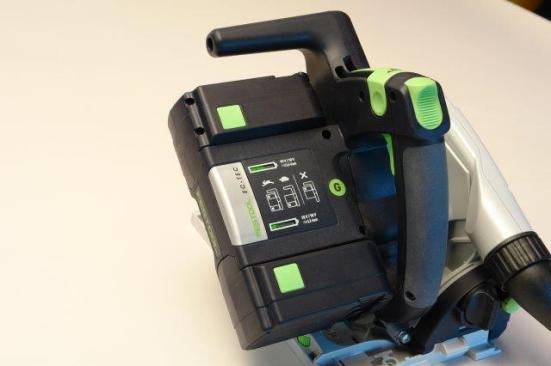

The saw can run on one battery, but two 18-volt batteries deliver 36 volts for optimal performance. The saw has two separate battery gauges on board.

During my nonstop testing, I found that the saw’s onboard battery gauges were misleading. While crosscutting the birch plywood, for instance, both led gauges dropped from three lit bars to one after I made just 18 of my 40+ cuts, and I was able to cut almost 70 more lineal feet after the bars started blinking to indicate that the batteries were almost drained. It took me two hours to recharge both batteries on their separate chargers.

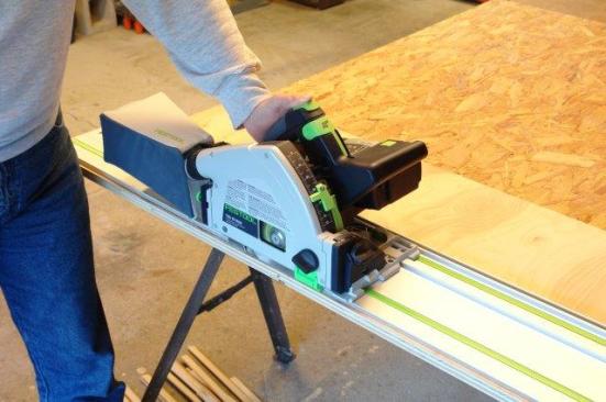

The author tested the saw’s power, runtime, and dust collection by making repetitive cuts in sheet goods and solid lumber. The photo shows a metric depth scale, but the saw is now sold with an imperial scale instead.

According to Festool, the TSC 55 IMP. collects about 96% of the dust when hooked to a vacuum and 92% when used with the included dust bag. In my testing, I could indeed tell that the vacuum pickup was slightly better, but was surprised to see that the difference was barely noticeable. And given that this is a cordless tool, shedding the squirrelly, snagging vacuum hose is a godsend. If you let the bag overflow, though, you’ll be rudely awakened by a burst of sawdust. When cutting ¾-inch plywood, my bag consistently filled completely after cutting 44 lineal feet. Except for a couple of times when I forgot, I emptied it right before it filled.
Whether you use the dust bag or a vacuum, you must lower the saw’s viewing window or splinterguard so it touches the stock you’re cutting or a lot more dust will blow out the front. Also, if you’re just shaving an edge, neither the vacuum nor the bag works well. Even at maximum dust-extracting efficiency, you get a little spray of sawdust out front as the saw blade exits the stock you’re cutting.

Festool’s cordless, brushless TSC 55 IMP. LI XL can handle anything that its corded counterpart can, which makes it ideal for casework, finish carpentry, and woodworking. The bag works great and the battery runtime is impressive when running on two 18V batteries, though I wish the battery gauges were spot on. Shedding the usual cord and vacuum hose is like shedding a ball and chain, making it much easier to bring the saw to the work and to maneuver it through cuts. Whether it’s worth paying $825 for the full cordless set versus $660 for the corded equivalent depends on the work you do.
