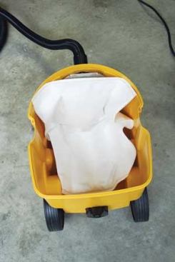

When debris enters a HEPA vacuum, it's captured in a collection bag – usually paper (above) but sometimes fleece (below). Fleece bags cost more but are tougher and can be filled more completely without a loss of suction.

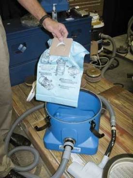

Bags. Most vacuums take paper bags, some take fleece bags, and a few take both. Paper tends to clog more quickly than fleece. Here’s why: When a vacuum comes on, the bag – whether paper or fleece – inflates; when the vacuum goes off, a paper bag will maintain its shape, but a fleece one, being more flexible, will collapse a bit. The next time the vacuum comes on, the fleece bag will snap back to its fully inflated shape, causing the caked-on dust to crack and fall in with the rest of the debris.
Fleece bags also cost more, but they may be more economical to use because they can be filled more completely without losing suction. Plus they’re tougher than paper, so they’re less likely to break when you take them out of the machine.
