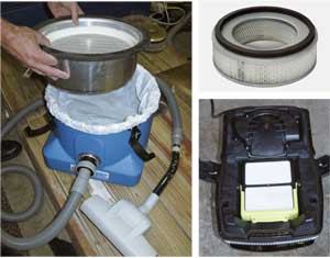

HEPA filters are designed to stop 99.97 percent of particles down to 0.3 microns in size. The oversize filter in this Mastercraft model (far left) installs over a prefilter, which extends its life by capturing most of the fine dust that gets through the collection bag. Like most HEPA filters, the Dustless Technologies filter (above left) is gasketed to prevent air from leaking through. The rectangular filter in Festool's vacuum (left) fits into a frame
