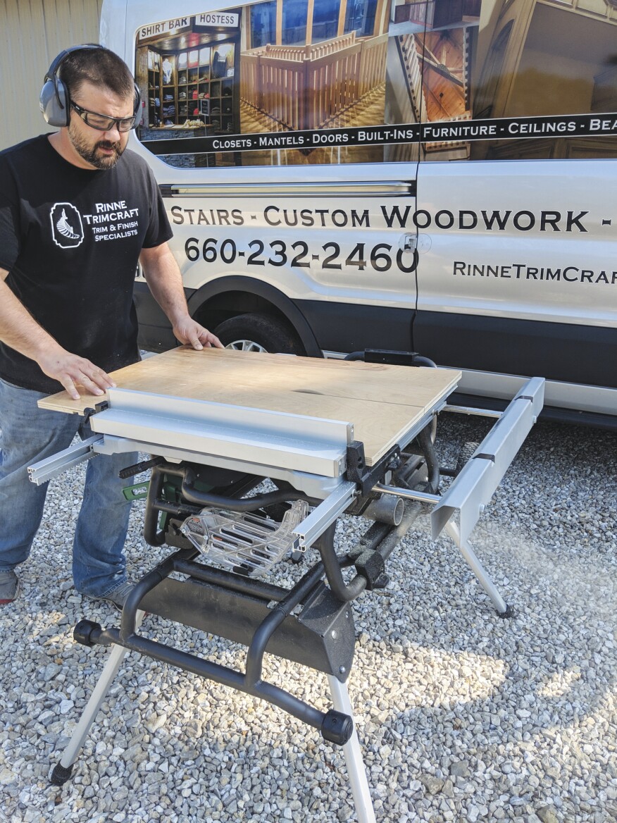

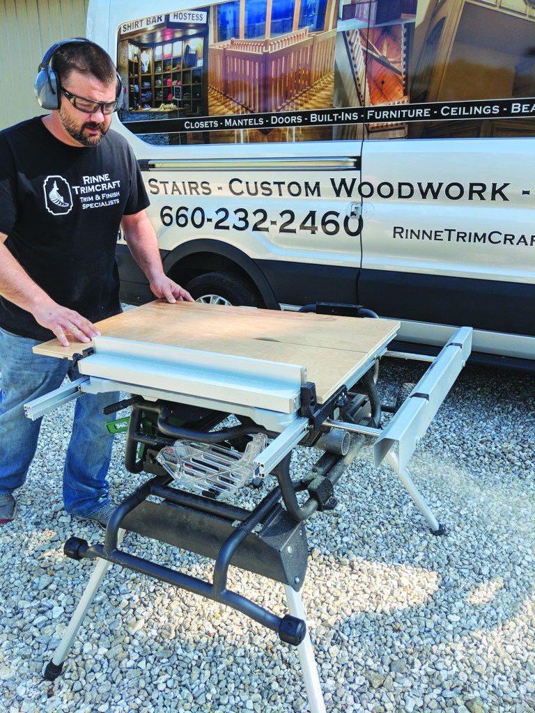

At 5,000 rpm, the saw can handle the hardwood and plywood the author works with, and he gives the outfeed support bar high marks.

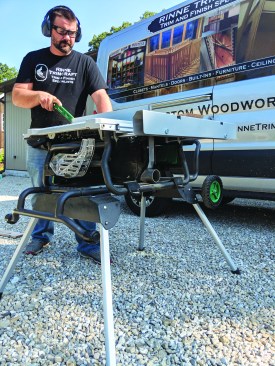

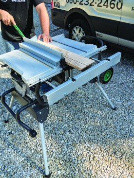

The optional folding stand bolts to the saw and has locking legs.

This saw appears to be well made with features that show a great deal of forethought in its design. For starters, the onboard storage is second to none. It holds the blade-guard assembly, small parts, auxiliary fence, included push stick, miter gauge, and the anti-kickback pawls, all within easy reach. The large table surface (28 3/4 inches by 22 inches) is backed up with an indispensable adjustable outfeed support bar that you will wish you had on every saw you’ve owned.
The rack-and-pinion-style fence is the most easily adjustable fence system on jobsite saws today. A simple release lever unlocks the dial, which in turn can fine-tune for a cut with relative ease. The fence also has a secondary narrow fence that, when flipped into the horizontal position, is used as a work support for pieces wider than the table top.

The optional stand features a design that makes one-person transport much easier. Wheels that have no trouble going through gravel and other terrain make the tasks of pack-in and pack-out a bit easier. The legs operate much the same as those on my miter-saw stand, with a spring-loaded ball catch. They both unfold and collapse easily. The metal used isn’t what I’d call heavy duty, but it does seem to do the job.
The saw must be mounted to the stand with bolts, which could be a pro or a con, depending on your preference. Some carpenters would prefer a quick release to separate the two, while others would rather carry the saw and stand together for fast setup. One thing worth noting is that the saw and stand together have a fairly large footprint. You aren’t going to throw this in the backseat of your crew cab.
