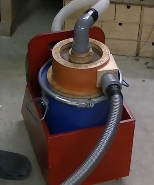

A cyclone saves collection bags by diverting the bulk of the dust to a vessel upstream from the vacuum or dust collector. Most people who have them buy them as attachments because they are not that expensive. But Cosmas Bauer is not “most people”; he’s one of those guys who likes to build his own equipment.
We covered Bauer’s home-made metal-cutting track saw a few months back. The cyclone was an equally challenging project because it contained so many curved parts. You can see him build it in the video below.

2:15 – Nice fit.
2:25 – Whoa, he made his own table saw too!
2:50 – I saw a guy take off the end of his thumb doing something like this. It would be better to clamp the work to the table.
3:45 – That’s a nice way to get the shape of a cylinder hitting a curve.
3:53 – More clever marking of the junction between two curves.
4:40 – Seeing him flush out the fit of these curved pieces makes me wish I had a spindle sander.
7:25 – It looks like he’s positioning the opening in the outgoing port in such a way that the heavier dust has time to settle before the air leaves the vessel.
10:44 – Ok, we know the vacuum works.
11:25 – The cyclone works too; there’s dust in the tank but not in the bag.
