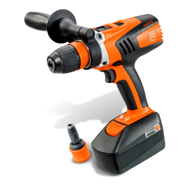

One of five new cordless drills and drivers introduced by Fein at the most recent STAFDA show, the ASCM18QX offers several advanced features and one feature that is entirely unique, a four-speed gearbox that allows the tool to run at up to 3,850 rpm. Most cordless drill/drivers top out at less than 2,000 rpm. Changing gears on a two- or three-speed drill means sliding the shifter forward and back; with this tool the shifter goes left and right, and forward and back—which gives you four different positions.
The new drill/driver has an electronic clutch and a removable chuck and bit holder similar to those offered by Festool and Metabo—though the system does not currently include a right-angle chuck.
With its brushless motor and supplied 4.0 Ah battery the ASCM18QX promises to have excellent runtime; Fein says it can drive 1,800 screws per charge. The company doesn’t specify the size of the fasteners or material being driven into but a photo on the website shows the tool with softwood lumber and what look to be 1 5/8- or 1 3/4-inch hi-thread drywall screws. That’s a whole lot of screws, but not any more than what other brushless drill/drivers with 4.0 Ah batteries can do.
This is one of several new 18-volt tools in a series that includes a hammer drill/driver, two-speed drill/driver, impact driver, and impact wrench. The drills are made in Germany; the impact tools in China.
