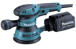

The BO5041 sander is a 5-inch random-orbit sander with a fixed rear handle like the one you’d find on a half-sheet sander, and a positionable front handle like the one you’d find – well, only on this tool. There are a few random-orbit sanders out there that have both rear and front handles – mostly larger 6-inch units – but Makita’s movable front handle seems unique to this tool.
The grip positions on standard hourglass-shaped random-orbit sanders are limited to the top grip and the body grip. Most of the time, users hold the tool at the top, but the body grip is helpful for applying even pressure down low – especially when irregularities in the wood surface cause the sander to track wildly off its intended course. Holding the tool by the handles on both sides makes it easier to guide through these squirrelly areas until they are flattened. Holding the tool with both hands also allows you to apply downward force without enduring as much arm and wrist strain.
With the BO5041 sander, versatile grip options abound. The shape of the tool provides a comfortable top grip. And by unscrewing the rotating front handle and removing the clamp that grips around the sander, you can get a decent body grip too. Just about the only grip that doesn’t work well is holding the rear handle only. Without pressure centered over the sanding disk, the tool tips easily.
The sander has a speed range of 4,000 to 12,000 rpm, which is controlled by a dial at the junction of the tool’s top and rear handles. We worried that changing hand grips during sanding might inadvertently move the speed dial, but this didn’t happen. The tool’s two-finger trigger is comfortable enough, but using the lock-on button is the key to preventing finger fatigue.
Even though this new sander has the same speed range, 3-amp motor spec, and average-sized 1/8-inch orbit as the Makita model in the category test, it feels more powerful. It has a low hum and proved very difficult to slow down, even if you really lean on it.
Taking a page from the Winter-issue sander test, we used some of the same performance criteria when evaluating the BO5041. We sanded a hard maple board for three-minute intervals with a fresh 100-grit disk to determine both stock removal and dust-collection efficiency. By weighing the board and dust container before and after each trial, we were able to measure the amount of wood removed as sawdust as well as the percentage of that sawdust captured by the tool’s on-board dust container. Because it was the same board we used in the prior test, we ended up with values that were directly comparable to those measured from the other sanders. With an average of 10.6 grams of stock removed, the BO5041 outpowered all the tools in the previous test. Its 78.3 percent rating nearly equaled the second-best sander in collection efficiency. This is especially good news in light of the fact that it’s nearly impossible to connect the tool to any common vac hose for dust collection. User-felt vibration was very good, as was the quality and coverage of the sanding scratch pattern.
The Verdict
The Makita tool in our Winter full-category tool test took a respectable fourth place, and we liked this one even better. The extra stability provided by the front and rear handles enhanced our feeling of control, and the variety of grip positions was a welcome comfort feature during marathon sanding sessions. Add to that the tool’s very efficient dust collection and class-leading stock-removal power, and you have yourself a mighty and versatile sander.
