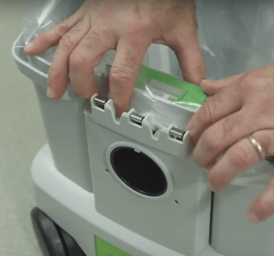

Use the right extractor

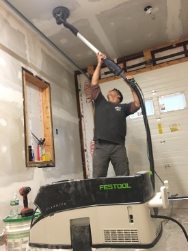

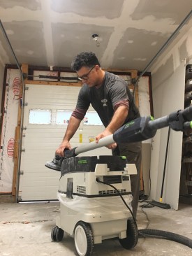

The Planex EZ creates a lot of dust, so you need to make sure you’re using an extractor that can keep up with it. Of the Festool-brand dust extractors, Festool vehemently recommends the CT36 AC, and nothing smaller. Can you use an extractor from a different manufacturer? If it has comparable amounts of suction, a good filter system, and auto-clean, you should be fine. The Festool CT36 AC has a max air flow of 138 cfm and a 96-inch static water lift.
Use the clear disposable bags, not the self-clean fleece filter bag. These bags have a white box and “x” cut on the sides. Keep the bag below the white bin of the extractor (where the top clicks in). Those “x”s help the bag "breathe" during use, allowing it to fill with dust instead of air for maximum fill capacity.
Put the extractor in “Auto” then turn it to AC one time before you start sanding. Toggling to AC gives two to three bumps to the filter, helping to keep it clear of dust. There’s an optional accessory called a "blast gate," which is supposed to help keep the filter clean and the extractor running more efficiently over time; you close it once in a while to raise the extractor’s suction level. (The Cleantec 36AC comes with a 1-micron filter, which is not suitable for RRP lead-paint work.)
Note: Although the dust extractor has an auto-clean system, it still needs to be manually cleaned once in a while. When you notice that the suction level changes as you’re sanding, it’s time to clean out the air filter. It’s easy to remove, and requires simply opening the pleats up over a garbage can and knocking loose the caked-on dust. It’s also okay to blow out with an air compressor, though be prepared for a dust storm.

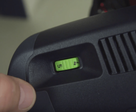

When I first started using the Planex EZ, I had no idea what speed setting to use. You can choose between 1 and 6, which has an rpm range of 400 – 920. Slow and a coarse grit is best for textured surfaces and popcorn ceilings. The only guidance Festool gives with respect to speed is to start at about 4.5 until you get used to the sander. Too slow and you’ll end up with swirl marks. Too fast, and you’ll tear through the finish (and maybe the paper, if you’ve never used a sander before).

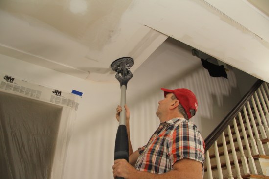

Position yourself beneath the sander
Stand as directly under the sander as possible to minimize shoulder strain. For extended overhead work, Festool sells a harness kit ($260; sold separately). The harness helps to transfer the weight from the shoulders to the hips.

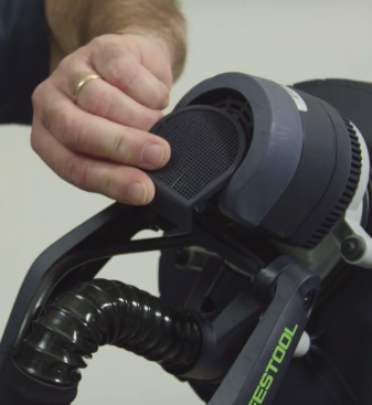

Before you store the sander at the end of the job, Festool recommends vacuuming the backing pad of the sander. It is also a good idea to store the sander with abrasive on the pad. This keeps the pad from taking up any miscellaneous debris in storage. Also, a light puff of compressed air (low pressure) to the head and body of the sander is helpful. The motor itself has a protection screen to help keep large debris (drywall bullets) from entering. This screen may need to be removed and cleaned occasionally.
