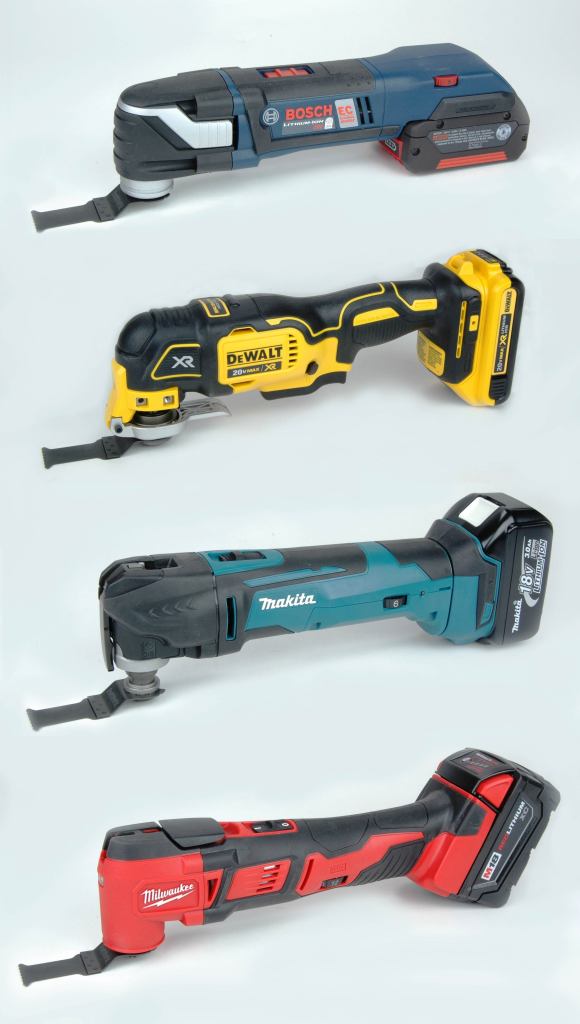

Bosch MXH180BL
DeWalt DCS355D1
Makita XMT035
Milwaukee 2626-22
Tool-free accessory attachment is standard with all of these new-generation OMTs. The sleek blade clamp design of the Bosch MXH180 has no loose parts to juggle while changing blades and was a standout feature among the tools tested. For a detailed review of this model see  Bosch MXH180BL.
DeWalt’s DCS355 design is all its own, with a variable speed trigger instead of a fixed on/off switch and an exposed spring-loaded blade clamp lever. Instead of making a version similar to Fein’s original OMT designed decades earlier, DeWalt changed up the form and features more that any other brand. Thinking outside the box made for an interesting tool with a few hits and a few misses. For a detailed review of this unique model see  DeWalt DCS355D1.
Makita is the only manufacturer in this test that also had an 18-volt cordless OMT in the last test (the LXMT02), but this Makita XMT03 is a newer model. The main difference is the tool-free blade clamp but this new model is also larger and heavier. For a detailed review of this low-vibration tool see  Makita XMT035.
The Milwaukee 2626-20 is one of two tools in the test with an LED headlight for a better view of the cutline in shadowy conditions and generous rubber surfaces all across the bottom of the tool for improved grip comfort in a variety of positions. These improved ergonomic and usability features are well appreciated, as is the standard battery fuel gauge. For a detailed review of this model see  Milwaukee 2626-22.
