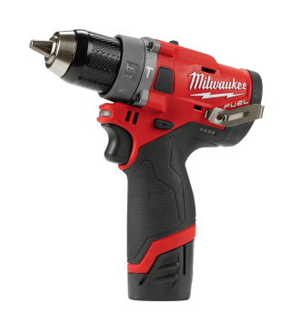

M12 Fuel Drill/Driver and Hammer Drill:
The drill/driver and hammer drill both feature an all-metal ½-inch clutch. Their brushless motors run up to 1,700 rpm and deliver 350 in.-lb. of torque (peak). Both drills weigh 2.8 pounds with a battery. The drill/drivers are 1 inch shorter than previous generations.
Milwaukee Electric Tool Corp

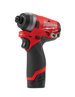

M12 Fuel ¼-inch Impact Driver
The impact driver also features a brushless motor that runs up to 3,300 rpm and delivers 1, 300 in.-lb. of torque. Four modes offer added control, depending upon the application. Mode 1 allows for greater precision, keeping the rpm between 0 and 1,200. Mode 2 is meant to prevent snapping heads and stripping screws by maintaining 0 to 2,400 rpm. Mode 3, which Milwaukee calls “performance,” runs at the full 0-3,300 rpm. A new “Self-Tapping” mode does three things. To start the screw, it spins it up to 3,300 rpm. Once the threads engage, it lowers the rpm to max out at 2,400. As the screw tightens, the driver slows further to 800 rpm to reduce stripping.

M12 Fuel 1/2″ Drill Driver (2503-22)
  • RPM: 0-1,700
  • 350 in.-lb. of peak torque
  • ½” all-metal chuck (included)
  • Length: 6.6”
  • Weight (w/ battery): 2.8 lb.
  • Cost: $170 (Kit) $120 (bare tool: 2503-20)
  • Kit includes: M12 Fuel 1/2″ Drill Driver, M12 Redlithium 2.0 Compact Battery Pack, M12 Redlithium XC4.0 Extended Capacity Battery Pack, Charger, Belt Clip and Carrying Case

M12 Fuel 1/2″ Hammer Drill (2504-22)
  • RPM: 0-1,700
  • 350 in-lb. of peak torque
  • BPM: 25,500
  • Length: 6.6”
  • Cost: $180 (Kit) $130 (bare tool: 2504-20)
  • Kit Includes: M12 Fuel 1/2″ Hammer Drill, M12 Redlithium 2.0 Compact Battery Pack, M12 Redlithium XC4.0 Extended Capacity Battery Pack, Charger, Belt Clip and Carrying Case

M12 Fuel 1/4″ Hex Impact Driver (2553-22)
  • 1,300 in.-lb. of torque
  • RPM: 0-3,300
  • IPM: 0-4,000
  • 4-Mode Drive Control
  • Length: 5.1”
  • Weight (w/ battery): 1.76lbs
  • Single-handed bit insertion
  • Cost: $180 (Kit) $120 (Bare Tool: 2553-20)
    Kit Includes: M12 Fuel 1/4” Hex Impact Driver, (2) M12™ Redlithium 2.0 Compact Battery Pack, Charger, Belt Clip and Carrying Case
