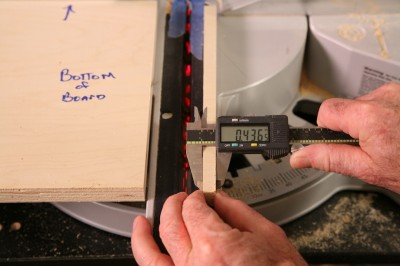

Calibrate the Miter Gauge
According to Collins, a cut that’s out of square even as small as .005 in. over about 10-in. would yield a miter joint on casing that would be visible from four feet away. For this reason, he takes great care in calibrating the miter gauge. He starts by squaring the blade to the fence. Depending on the saw, this can be done by either moving the fence or moving the miter scale. This is a multi-step process that involves making sample cuts and measuring their accuracy with a caliper (ideally).
Taking the time to follow this entire process will ensure precise cuts, greatly reducing the “cut until it fits” method which can waste a lot of time.
