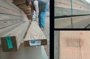

Copper azole and ACQ lumber (shown left photo,       copper azole 4x4 on left, ACQ 2x6 on right) look similar to CCA, so it's       important to read the end tags and verify deliveries with your supplier.
The CCA phase-out began Jan. 1, but lumberyards can still       stock it until inventory runs out.
Even though many dealers are educating customers, make       sure you know what you're getting.
SillBor from Arch Wood Protection can be used for sill plates and other non-exposed applications.
If you're not sure what type of wood you have, check with       your supplier and look for an end tag. The back of the tag should have a       quality mark similar to the one above that identifies its treatment content.
