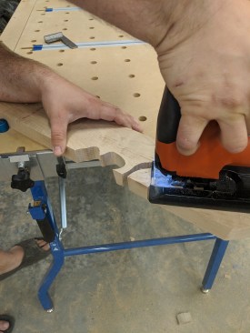

This saw can cut a tight radius.

Another important feature is how easily I can turn a tight-radius curve. Again, the Hilti performed flawlessly. With minimal effort, I can guide the saw along any inside or outside curve I put it up against. So effortlessly, in fact, that it increases accuracy: Because the saw is so smooth, I can follow a line extremely closely without accidental over-cuts or deviation. I attribute some of this ease to the saw’s surprisingly light weight. Add to this the integrated LED and dust blower that clears the cut line of debris, and it makes it that much easier to maintain accuracy in my cuts.

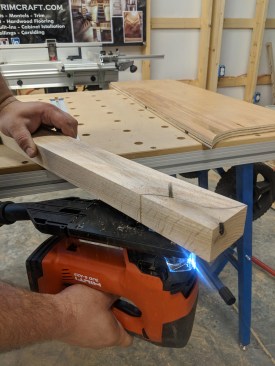

The jigsaw ate 2-inch-thick oak for lunch.

The 22-volt battery (one of the lightest batteries on the market, too) powers a motor that packs a serious punch. Even in 2-inch-thick oak, it felt like I was cutting MDF.

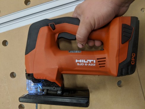

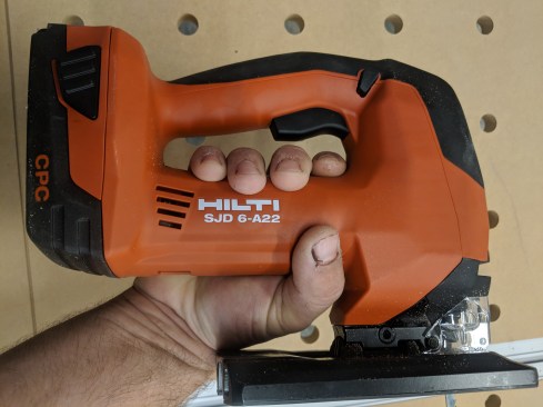

The grip and saw layout are terrific. The top handle could be custom made for my hand. And, I can grab the bottom like a barrel grip tool when I cut upside down, which I do frequently.

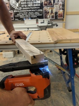

The Hilti design feels good in my hand. With a grip that’s both form-fitting and unobtrusive in my hand, Hilti nailed the ergonomics. I cut upside down a lot. This serves two masters: First, I can see the line better. Second, the cut is cleaner because the teeth exit the reverse side of the work. By engaging the throttle lock, I can use the lower body of the D-handle and it feels more like a barrel grip. This is important because I prefer barrel grips for upside-down cutting.
Cutting upside down provides a better view to the line and a cleaner cut.
A throttle lock makes upside-down cuts easier and more precise.

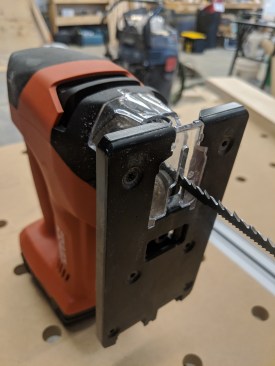

The base can be beveled up to 45 degrees with detents at the other common intervals. I find the release easy to reach and the detents to be dead-on out of the box. It’s not often I need to bevel the jigsaw, but when I do, it’s critical that feature not be a hassle. Some of the other high-end brands I’ve seen have separate beveling bases, which I find annoying. I like that Hilti incorporated it into the design.
The base bevels easily. No accessory base is required, as for some of my other saws. The detents were dead-on out of the box.
