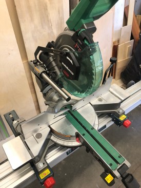

Out of the box the saw was a couple degrees out of adjustment. It’s not a big deal for us because it is SOP here for all saws to be adjusted before we use them.

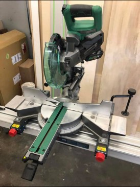

The Rail design enables this miter saw to be more compact than other tools. Great for setting up on a tight site location or a small shop.

Don’t throw your hold down clamp away. These are great for long floppy pieces, cupped pieces you want to lay flat, small pieces. We use ours all the time.

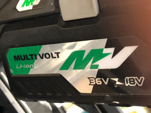

This saw you can operate on one Metabo HPT 36-volt battery or the Multi Volt AC adapter you plug into an outlet. On either platform you’ll get a comparable power delivery of a 120-volt 15amp corded power tool.
Don’t believe me? On a single charge the battery lasted 2 days of cutting 2-by pressure treated lumber all day while framing and trimming out a deck that included a privacy fence. It was a beast and still wanted to keep going. In the shop, we cross cut hardwood, as well. In all cases, plenty of punch.

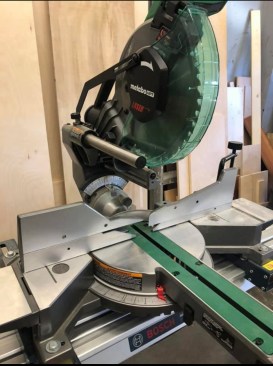

Up front controls for miter and bevel are nice and work well. I wish the detent design was more robust and while the saw had plenty of power—corded and cordless—accuracy was an issue for our higher end work. Rough carpentry, this thing was Beast Mode for sure.

We squared the saw up and all those adjustments were easy to make. While we do this to every saw we buy, the Metabo was 2-3 degrees out of square on the miter out of the box. The bevel was dead square.
While checking and adjusting for square, we noticed there was play in the saw head. We had to be very careful to not put too much pressure here to get clean cuts.
Next, we noticed the detents. They didn’t hold as fast as other saws we have. I flipped the saw over and took a peek and my sense is the parts for the detents are plastic-y and undersized. The saw didn’t lock into angles securely enough for my purposes. Other tools’ positive detent stops are much more robust and lock the angle. The Metabo leaves a trim carpenter or woodworker with a sub par cut in my opinion. Framing and rough carpentry is OK, but for what we do…
Next, the rails. The slide action wasn’t as smooth as my other saws and I could feel it in both directions—push and pull. What’s good about the rails is that they’re compact and don’t travel too far past the saw, so if you’re setting up in a small shop or hallway, you can get closer to the wall.

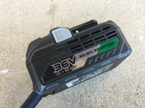

The transformer is basically a corded battery shell and fits the battery slot easily.
With this saw you essentially purchase a corded saw and can graduate into Metabo HPT’s cordless 36-volt cordless system as you see fit.

To really run the saw hard, we made long cross cuts at 45-degrees on 1-by and 2 -by maple. The saw motored through the material without a fight. It was here we noticed that the play in the head showed up again because it left a wavy cut.

It has a great hold down clamp with a rubber foot so you don’t mar your material and can be used on either side of the saw.
By the way—don’t throw your hold down clamp away. I love these things. They’re great for securing floppy composite decking or molding square to the fence/table. They’re great for long pieces. Short pieces. Wide pieces you really need to get flat to the table. It’s safer than hand-mashing the piece to the table. It helps make cleaner cuts. And it saves time.
One other feature we liked a lot was the compact slide. The rail design enables the head to slide in a smaller footprint, which is great if you’re set up in a hallway or small shop.
