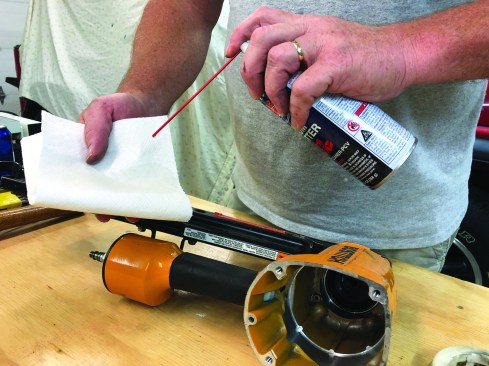

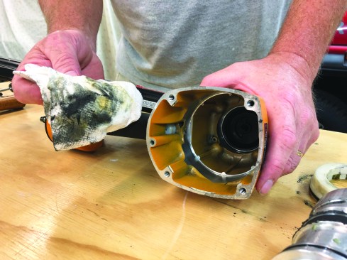

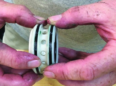

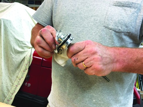

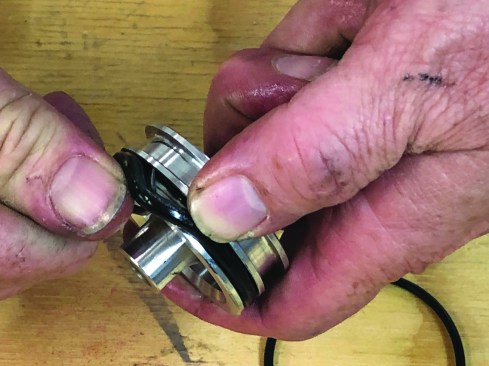

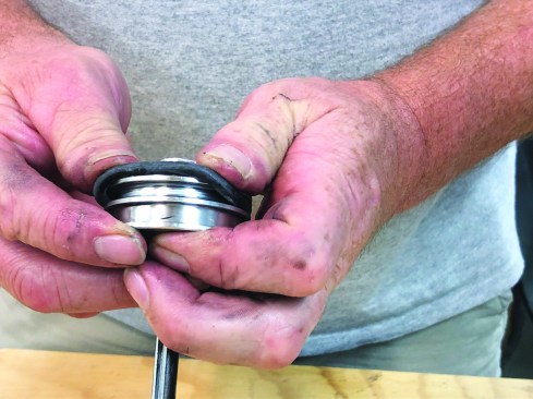

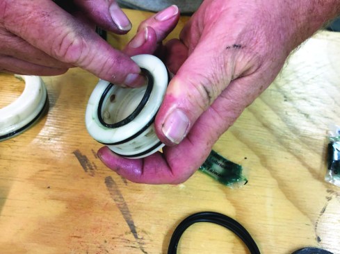

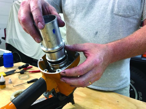

OK, I admit it: I love buying tools. But I also want them to work properly and last a long time, so I always take good care of them and do routine maintenance, which saves me a lot of time and money in the long run. Pneumatic nailers—from headless pinners and finish nailers to roofing and framing nailers—are regularly part of my tool arsenal. These nailers are all similar on the inside, and periodically or when a project has given one a particularly rigorous workout, I tear them down to clean them, inspect them for wear, and replace the seals and gaskets.

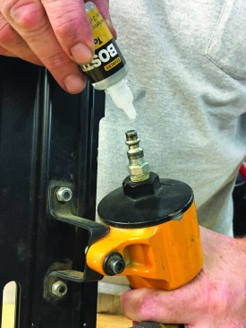

While rebuilding pneumatic tools is a good idea after an extended time, I also do several things with every use to keep these tools in good working order. I always put a couple of drops of air-nailer oil in the nozzle before connecting the air hose. After every job, I blow off the tools to remove dust and debris. Water vapor in the air lines is especially hard on nailers, so I drain the air from my compressor after every use to remove moisture from the air tank. In some areas with constant high humidity, you may need to install a device to physically remove the moisture from the air lines.
In addition, I try to operate air tools at the proper cfm. Too much pressure can damage a nailer, and too little pressure can result in poorly driven fasteners. Finally, I always use fasteners with the proper angle, head type, and collation made specifically for my nailer. Using the wrong fastener can make a nailer jam, misfire, or double fire—all of which can be dangerous.

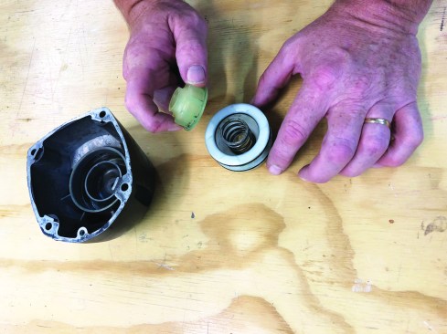

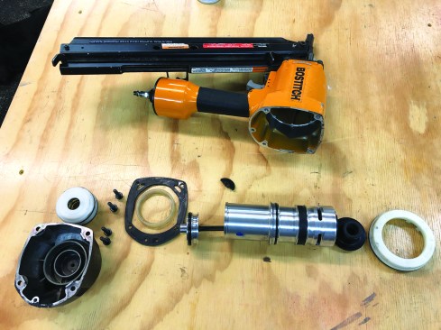

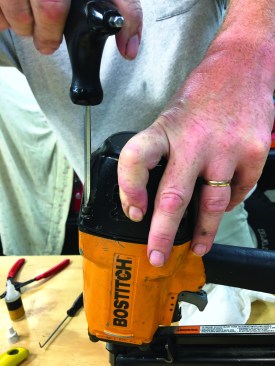

I recently rebuilt my old Bostitch framing nailer. I bought an O-ring maintenance kit online that works for several Bostitch nailers. Then I cleaned and decluttered my workbench so I could keep track of all the nailer parts. I removed and sorted the contents of the kit, separating all the parts on my workbench. I also gathered all the tools, cleaners, and lubricants that I’d need, and I was ready to start.
