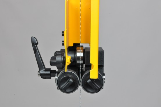

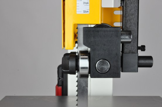

I. Follow the 3 laws of blade care. 1. Proper tension. 2. Proper tracking. 3. Proper guide setting.

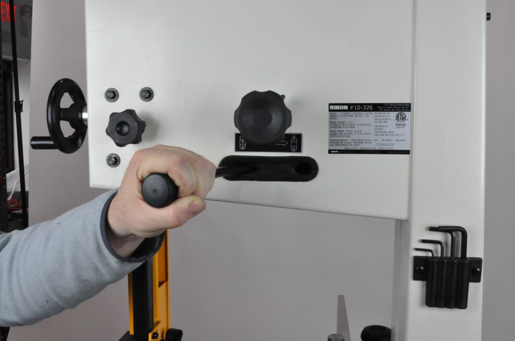

II. Set the proper tension. “Tension is number one because without it, you won’t have proper tracking and guide positioning,” Burrow says. “Try a test cut. If you put a square against a test cut and the test cut bellies in the middle, you’re under-tensioned.”

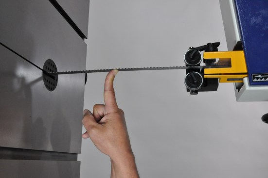

III. Use this rule of thumb index finger. Is your blade under-tensioned? Raise the guide post to its maximum height and press the broad face of the blade with your index finger. If your color under your finger nail goes white (about 7 pounds of pressure) without giving up more than a quarter-inch of deflection, blade tension should be fine.
IV. View the manufacturer’s blade guide with caution. “The tension scale of your band saw manufacturer doesn’t anticipate all blade variables, like blade thickness, length, overcut, and undercut,” says Burrow. The tension scale only gets you close. It’s up to you to make the final tension adjustment.

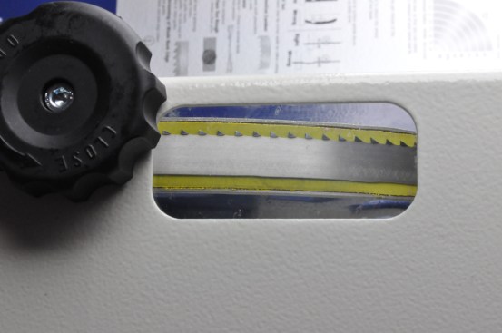

IV. Check blade position on the wheel. “Line up the center line of the blade to the center line of the wheel. Centering any other way will probably cause a problem with guide positioning,” Burrow says.
