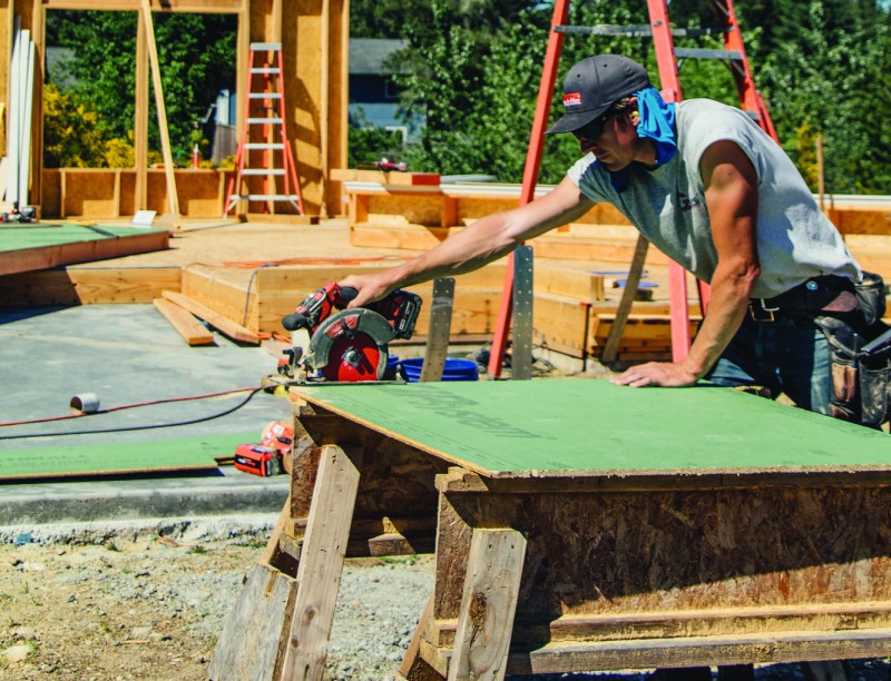

We first had an inkling that an all-cordless framing site might be possible when we got a Milwaukee M18 Fuel cordless saw (see photo, above). This is a 6 1/2-inch, blade-left circular saw. It isn’t super-powerful, but it does a decent job for many smaller sheathing cuts. Using it meant we needed to drag one less cord around the site during pick-up work.

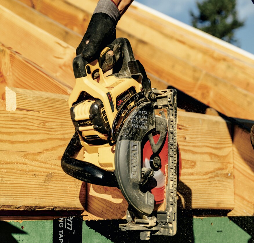

Only recently introduced, DeWalt’s in-line saw is well-balanced and  cuts faster than, though not as deep as, the Makita.
DeWalt recently introduced its own in-line saw, which we’ve used for about a month. The jury is still out for me, but I’m leaning slightly towards the DeWalt over the Makita, though both are great saws. The DeWalt is much more powerful and is faster. It doesn’t get bogged down but powers through LVL, and it has a great sight line when I’m making cheek cuts. Granted, the balance isn’t as good as the Makita’s, it takes longer to charge, and I don’t think the runtime is quite as good. But the DeWalt is a beast of a saw and because we cut so much 2×12, I think that gives it an edge for us. Still, the Makita can cut 2 1/2-inch I-joists in one pass, so I’m fortunate to have both on site.

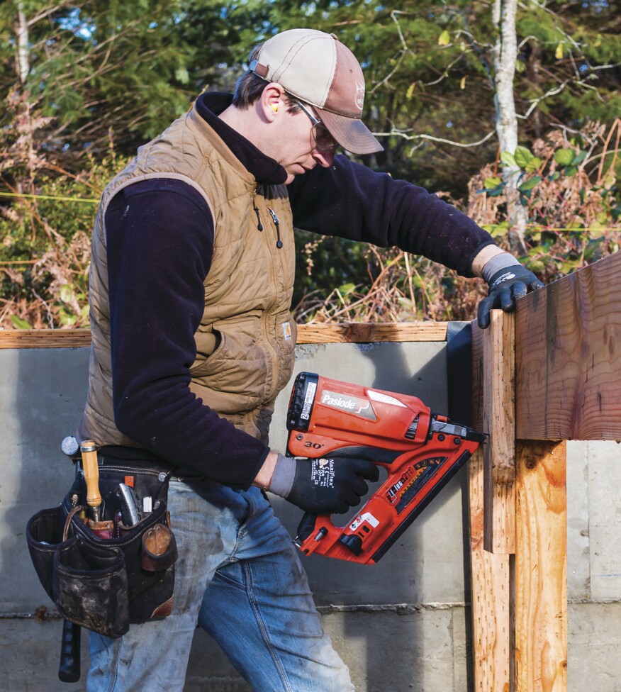

I’ve been working with fuel-power framing nailers for a while, hoping they would eventually work for production framing. The early attempts from Paslode and Bostitch were not convincing.
The Paslode XP
The Paslode XP
The DeWalt DCN690
The DeWalt DCN690
The Hitachi NR1890DR
Then we reviewed the Paslode XP, the DeWalt DCN690, and most recently, Hitachi’s battery-powered, brushless nailer. We like all three of these guns. None of them are suited to production work, because they carry only one clip of nails at a time, but we use them regularly for pick-up work and even for roof framing. While I can’t yet give up my Max high-pressure coil framing nailers (they carry around 300 nails per coil), the new-generation cordless guns are impressive enough that we find ourselves reaching for them more and more often. They are the go-to guns for punch-list work or for any work up high where maneuverability is an asset.
