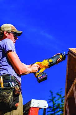

The DeWalt Flexvolt actually cuts a little faster in thick material, but it’s heavier.
This cordless tool cuts faster and provides better control over the cut than any other recip saw I’ve ever used. It has all the power I need, without the inconvenience of a cord to drag around. It also has a built-in ladder hook, which is handy when I’m doing work up high. One thing I especially like about this tool is its low vibration, because that translates to less fatigue.
We have also used a DeWalt Flexvolt recip saw. This saw doesn’t cut as fast as the Milwaukee through everyday 2-by stock, but surprisingly, it does cut faster through thicker, 4-by stock. That isn’t enough incentive for me to use it instead of the Milwaukee. If, however, I were already heavily invested in the Flexvolt ecosystem, the DeWalt would work perfectly fine as our only recip saw for framing.

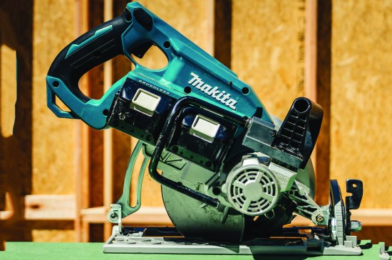

The Makita XSR01PT is powerful enough to compete with corded in-line saws. It has a large rafter hook, which tucks out of the way.

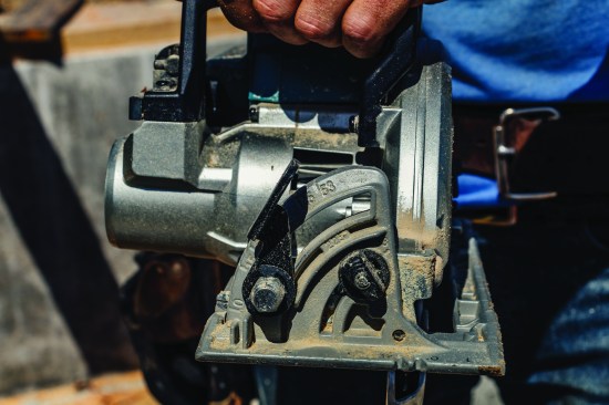

Its table tilts up to 53 degrees.
For us, the turning point to an all-cordless framing job came last spring when Makita released its XSR01PT cordless rear-handle circular saw. This saw looks a lot like the Skilsaw worm drives many of us in the West grew up using, and it packs as much power. So far, we haven’t found any situation in which the Makita made us wish we had a corded saw rolled out. I’ve ripped 3-foot pieces of 1 3/4-inch LVL to try and overheat it, to no avail. Ripping three layers of 7/16-inch OSB for roof sheathing didn’t present any problems either. I can get the saw to stop if the material starts binding, but I can also do that to every corded saw I’ve ever reviewed.

This Makita saw runs off two 18-volt, 5.0-Ah batteries that are stored directly behind the brushless motor and under the top handle. The batteries are located roughly in the center, keeping the weight right in front of the handle. This layout allows the handle to be placed behind the motor as on the saws we love here in the West. In fact, the layout is nearly identical to that of all the other blade-left in-line and hypoid saws we’ve reviewed over the years. Its rear-handle design is more comfortable than a top-handle configuration because you push the saw; top-handle saws involve pulling at an odd angle and have less reach when you’re cutting rafter tails and sheet goods.
The Makita saw bevels to 53 degrees with positive stops at 22.5, 45, and 53 degrees. With a 7 1/4-inch blade, it has a cutting depth of 2 9/16 inches (3/16 inch more than my Skilsaw 77). That means we can use the Makita to cut 2 1/2-inch flanged I-joists, instead of our Big Foot, which is harder on the arm. On some jobs, the engineer requires us to use 3-by mudsill or 3-by blocking for straps; with the Makita, we don’t need to roll out another tool to make the cuts.
One feature we’ve come to love is the electronic brake and the relatively soft start, for safety. Unlike a wormdrive saw that will twist when the trigger is pulled, this saw doesn’t move. I’ve gotten used to the “kick” on my Skilsaw. The lack of kick, though, on the Makita means I can use it one-handed when I need to trim a rafter tail or even a wall plate. The electric brake and lack of kick on startup also make this a safe saw to train new framers with.
We loved this saw so much that we immediately bought a second kit. We have six batteries (we had two more for a drill/driver kit) and we have not yet had both saws down charging. The dual-port chargers claim to charge 5.0-Ah batteries in 45 minutes or less, and that seems about right; we charge these saws at lunch whether they need it or not. There is nothing about this saw that makes me want to reach for a corded saw. It has all the power and runtime we need.

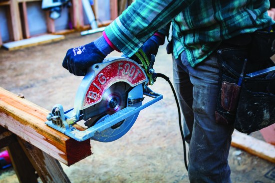

The last surviving corded saw on Uhler’s site is the 10-inch Big Foot saw. It’s only used  these days for finish beam cuts.

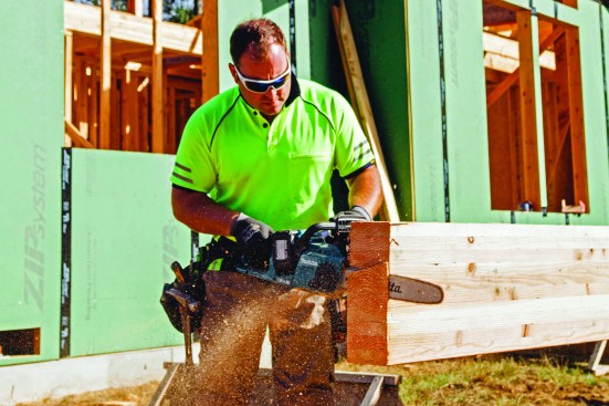

Rough cuts on large beams are easily  handled by a cordless chain saw, such as this 36V (dual 18V) Makita.
There is one corded saw we occasionally use that I think should be in every framer’s kit—the Big Foot saw. We don’t use this 10-inch beast as much as we used to, because we are often able to cut large beams with a cordless chain saw, but we do still use the Big Foot occasionally for finish cuts on exposed beams.

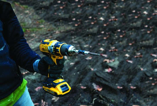

For a lot of smaller (5/8 inch or less) drilling work and for hanging doors, we use a DeWalt 20V Max drill/driver. With this tool, we typically use DeWalt’s smaller, compact battery packs. Whenever we can, we strive to reduce weight.

For driving many fasteners, DeWalt’s 20V Max drill/driver serves well.

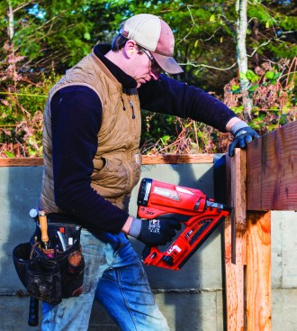

I’ve been working with fuel-power framing nailers for a while, hoping they would eventually work for production framing. The early attempts from Paslode and Bostitch were not convincing.
The Paslode XP
The Paslode XP

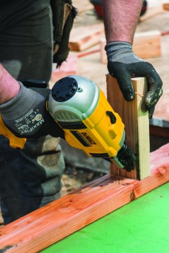

The DeWalt DCN690
The DeWalt DCN690
The Hitachi NR1890DR
Then we reviewed the Paslode XP, the DeWalt DCN690, and most recently, Hitachi’s battery-powered, brushless nailer. We like all three of these guns. None of them are suited to production work, because they carry only one clip of nails at a time, but we use them regularly for pick-up work and even for roof framing. While I can’t yet give up my Max high-pressure coil framing nailers (they carry around 300 nails per coil), the new-generation cordless guns are impressive enough that we find ourselves reaching for them more and more often. They are the go-to guns for punch-list work or for any work up high where maneuverability is an asset.

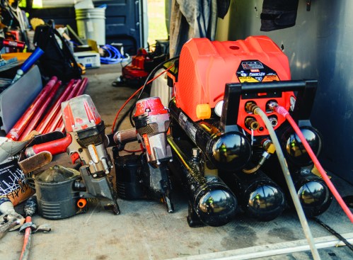

For the production nailing work of most wall and floor framing, cordless guns can’t compete with the author’s Max high pressure coil nailers and compressor.

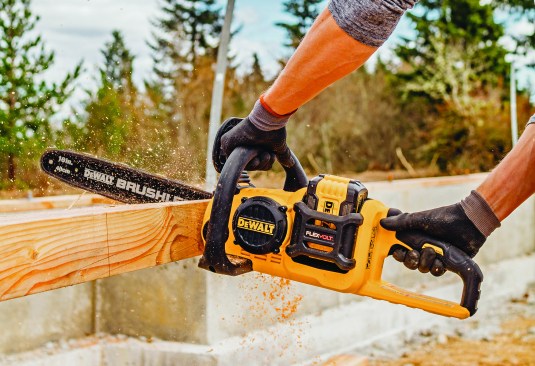

Last June, we decided to try going cordless to frame an entire floor system. It was a 1,800-square-foot floor framed out of 2×10 Doug fir on 4×10 girders to 4×4 posts over a 24-inch-deep crawlspace. We had just received a DeWalt Flexvolt chain saw to review, and we used that for cutting the girders, gang-cutting the joists, and even cutting the posts. We did all the drilling with the Makita cordless drill and all the nailing with the Paslode and DeWalt guns. We did not roll out any cords except from the power pole to the Sprinter van where we keep our chargers. For lighting our pick-up work, we used Milwaukee’s cordless tower light.
As the author began running entire framing jobs without corded power tools, he relied more and more on the fast-cutting Flexvolt chain saw for  gang-cutting joists and cutting posts.

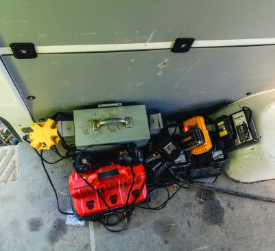

Typically, only one power cord  is rolled out to the author’s Sprinter van for all the chargers.

If you’re a remodeling contractor, I see no reason to invest in cords, compressors, and hoses. The electrical contractor and plumber we use have gone completely cordless, as well. When we are all on site, we have one cord for the chargers, one of which is also a radio. Of course, we still have two Max high-pressure hoses to run our coil nailers, and we run a router to cut out sheathing in window openings off that one extension cord. But that’s it.
