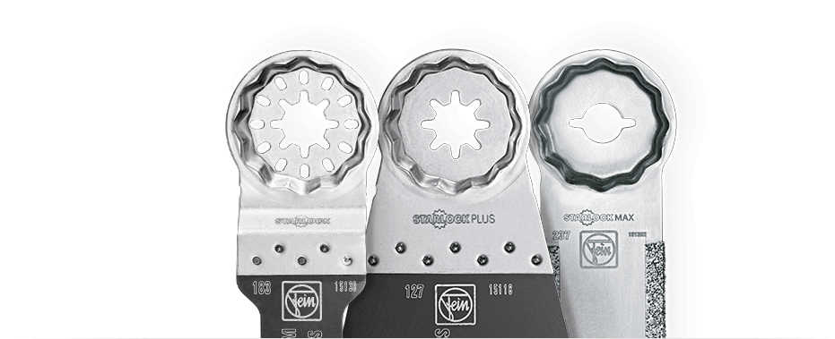

Starlock is an innovative, patented fitting system for attaching accessories to FEIN, Bosch and other selected Oscillating Multi-Tools (OMT’s).
Starlock is an innovative, patented fitting system for attaching accessories to FEIN, Bosch and other selected Oscillating Multi-Tools (OMT’s). The Starlock’s unique, 3-D design establishes maximum contact between the Starlock accessory and the OMT motor so 100% of the power is transmitted with greater security, efficiency, and less vibration. The design also makes blade changes possible in seconds with no tools required. Simply push the OMT onto the Starlock blade or accessory, and it snaps into place quickly and securely.
Because the Starlock system maximizes the power of each OMT, it will not only extend the life of both the blades and the tool, but it will also reduce the wear and tear on the user’s hands and reduce finger burns normally obtained when replacing blades that may have heated during use.
Easy To Use
There are three Starlock classifications: Starlock, Starlock Plus, and Starlock Max. Each is designed so its accessories take advantage of the OMT’s output, ensuring the greatest precision and heaviest loading. In addition, Starlock blades use an industry-standard color-coding system so it’s easy to determine quickly which blade is needed for the job.
Highly Compatible
Standard Starlock blades and accessories fit a wide variety of OMTs, including the following *:

While the standard Starlock accessories are compatible with the traditional Fein MultiMaster and many other existing OMTs, the Starlock Plus and Starlock Max have multitools made specifically for their use, and are not backward compatible.
This means that the Starlock Plus OMT can be used with Starlock and Starlock Plus accessories, but not Starlock Max accessories. The Starlock Max multitool can be used with Starlock, Starlock Plus, and Starlock Max blades and accessories.
