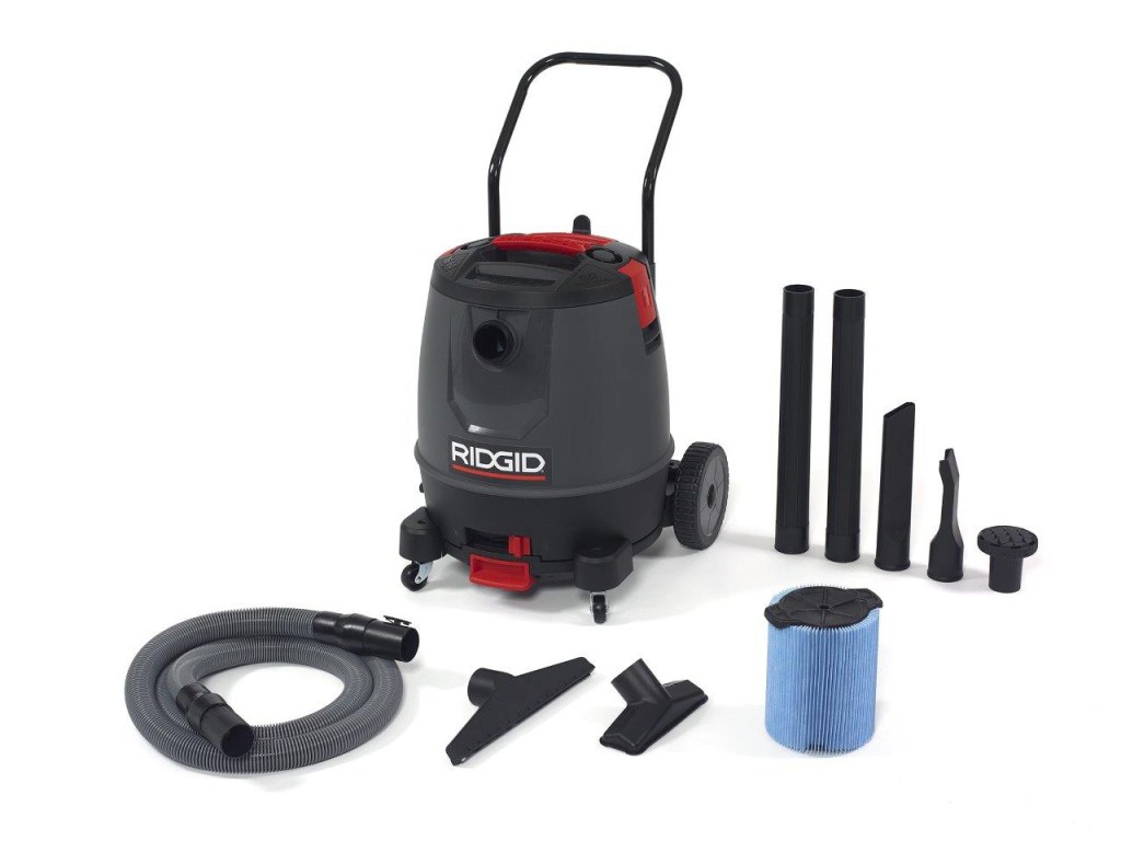

Ridgid recently announced a new line of 12 commercial/industrial-grade wet/dry vacs. The smallest has a 4-gallon tank and the largest a 16-gallon tank. All are said to have more powerful motors (by up to 24%) than the brand’s previous top-of-the-line models. Among the more interesting tools in the new line are the 1650RV, Smart Pulse RV3410, and RV2400HF (RRP/HEPA rated).
All are higher-end Ridgid models than can usually be found at Home Depot. I asked the PR person where they will be sold and was told they’re available from “Ridgid Distributors in the United States and Canada”. The RV2400HF is currently listed on the Home Depot website; the other two models are not. This is a brand new line so it might take a while for every model to become readily available. I was able to find the 1560RV and RV3410 on Amazon and a few supply houses that sell online.
The 1650RV is the first-ever vac to have a Motor-on-Bottom (MOB) design; the motor is below the drum/tank instead of above it (video below). This makes for a lower center of gravity and a vac that is less likely to tip when you pull on the hose.
A foot-activated power switch allows for quick, hands-free operation and the detachable drum makes it easy to empty debris. Items that won’t fit through the hose can be dropped into the tank through a hatch on the top. The vac is equipped with a handle and wheels and includes a 10-foot Pro Hose that can be bent 180 degrees without kinking. The included wands and accessory tools store on the machine.
Ridgid 1650RV Specs
Accessory diameter: 2 1/2 inches
Motor: 12 amps
Included filter: VF5000; 1 micron; very fine dust
Hose: 10-feet long; 1 7/8-inch diameter with 2 1/2-inch adapter cuff
Accessory storage: yes
Built-in drain: yes
Cord length: 20 feet
Capacity: 16 gallons
Included accessories: Two 2 1/2-inch wands, utility nozzle, crevice tool, car nozzle
Country of origin: Mexico
Price: $215
Available: April 2015
