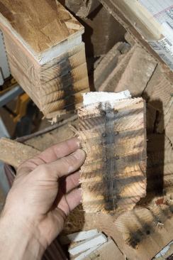

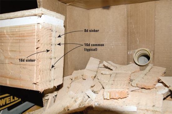

My first challenge was to come up with something to cut that would wear blades out quickly enough to separate the top performers from the also-rans. Yet I also wanted the test to be as realistic as possible, so I chose not to use stainless steel, hardened fasteners, or cement board, because those materials are not often cut during demo work. Nail-embedded wood. After much trial and error, I came up with a test plank of two 2x6s on edge glued up with a layer of OSB in between and capped with one layer each of drywall and OSB.
Each 8-foot plank contained a dozen rows of nails – 96 feet in all – laid end-to-end in kerfs cut into the 2x6s: ten rows of 16d commons, one of 16d sinkers, and one of little 8d sinkers that proved to be the assembly's secret weapon. By locating the nails along both sides of the central piece of OSB, I was able to concentrate wear on a limited number of teeth and hasten the destruction of the blades.
Building the planks was time-consuming but worthwhile, because it created a difficult but realistic test that would challenge every blade equally.

The test plank consisted of a piece of OSB sandwiched between 2x6s and capped with drywall and more OSB. The central piece of OSB was flanked by 12 rows of nails  – so the recip blade had  to cut 12 nails each time it went through the plank.

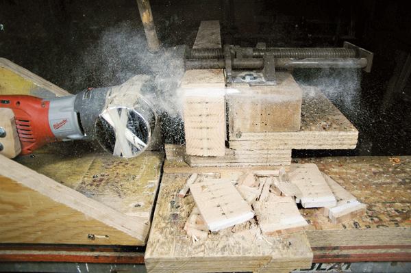

For timed cuts, the plank was clamped into a test rig and cut with a saw attached to a pivot arm. The nose of the tool was weighted to provide downward pressure – approximately 23 pounds at the blade.

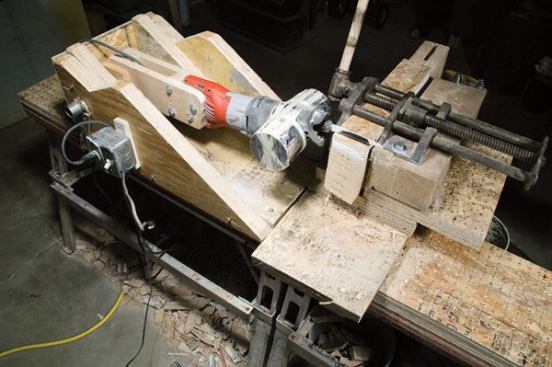

It's easy to count cuts but difficult to accurately time them while cutting by hand, so I had to build a test rig.
The rig consisted of a woodworking vise for holding the test plank and a sturdy pivot arm for holding the saw. Both were bolted to the thick LVL top of a worktable. For the test saw, I chose the most powerful Milwaukee Sawzall, a 15-amp model with a 1-1/4-inch stroke. To ensure adequate feed pressure, I strapped the weights from a 25-pound dumbbell to its nose. The feed pressure measured 23 pounds at the center of the blade.
During testing, I cut at high speed in nonorbital mode; the rig was so solid it transferred nearly all of the saw's energy to the blade. There was none of the shaking and vibrating you get when holding a saw.
The author used a stopwatch to time cuts through the test planks. A blade was considered dead when it took more than 37.5 seconds per cut; by that point, most blades could barely get through and were hot enough to char the wood.

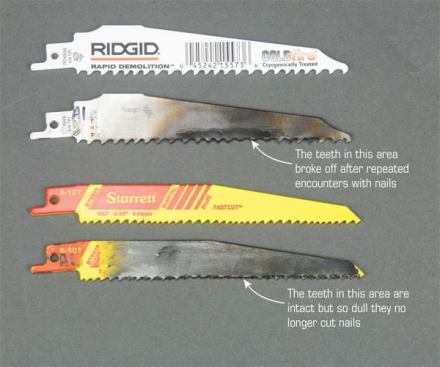

Tooth size alone is not a good predictor of longevity. The widely spaced teeth of the Ridgid blade (at top) cut quickly at first but were prone to snagging on nails. The more tightly spaced teeth of the Starrett didn't lose teeth to shock, but friction and heat eventually wore them down.

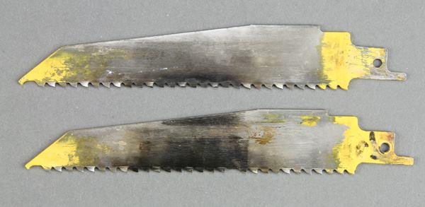

Blades cut faster and last longer when used in orbital mode. These DeWalt blades were tested to failure; the upper one made 53 cuts in linear mode and the lower one 100 cuts in orbital.
