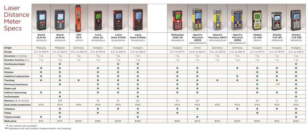

For this article, I evaluated 13 state-of-the-art models that cost about $115 to $280 and are accurate to within 1/16 inch or better. In my opinion, that’s the sweet spot for most residential and light-commercial work. I used the tools for several weeks, then compared their features, performance, and ease of use.
Range

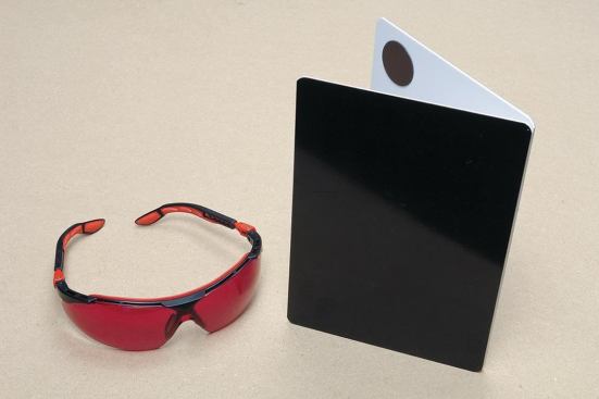

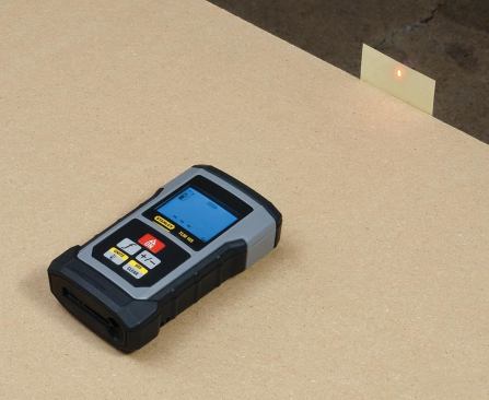

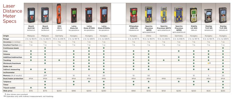

The spec chart on the previous two pages lists the range and accuracy for each model. To measure at the maximum distance, though, you need to aim the laser at a target plate like the ones sold by Bosch, Hilti, and Leica. These plates increase the measuring range and effectively magnify and brighten the dot for easier viewing. Aiming at typical building materials can reduce the range by 20% or more. Bright light, high temperatures, and unpredictable surfaces such as shiny metal can all cause measuring problems, but you’ll normally receive an error alert rather than an incorrect measurement when conditions are unfavorable.
Outdoors, the biggest issue is being able to spot the laser dot from a reasonable distance or in bright light. Using a target plate is one solution, but you have to position it and account for its thickness, which is extra work.
Laser-enhancement eyeglasses, on the other hand, make it easier to spot the dot without adding any extra steps. Wearing Hilti’s optional PUA 60 glasses, I could (with plenty of concentration) find the dot from more than 150 feet away when measuring to shaded yellow metal siding, virtually doubling my viewing range. When I tried to measure to a sunny section, I could barely see the dot at 10 feet without the glasses, but with them I could pick it out of the glare at 50 feet. Prices for laser-enhancement glasses start at about $10.

Accuracy
According to Stanley Tools, short FatMax tapes are accurate to 1/16 inch, not counting sag or temperature fluctuation. Long tapes are typically less reliable, declining to 1/2-inch accuracy at just 33 feet. By comparison, nine of the LDMs are supposed to be accurate to 1/16 inch, and four to 1/25 inch.
Some manuals recommend that you periodically verify the accuracy by setting up a fixed target at a known distance from the meter (Hilti recommends about 3 to 15 feet) and measuring the distance 10 times to check for deviation. I clamped a 2-by stop to one end of a kitchen island and used my FatMax tape to position a hardwood block 11 feet away to serve as a target, then took 30 shots with each model. I repeated the test another day with a white target plate. All 13 models passed the tests, straying within limits only occasionally.
Units of Measurement
All 13 models can measure in fractional inches, feet and inches, decimal feet, and metric units. The Leica Disto E7300 and E7400x and the two Stanley models also display decimal inches, while the Bosch GLM 80, Hilti PD 5, and Spectra Precision QM75 and QM95 can show decimal inches and yards. For finish carpentry, I appreciate the models that display fractions down to 1/32 inch. Six of the models do that, while the rest go down to 1/16 inch.

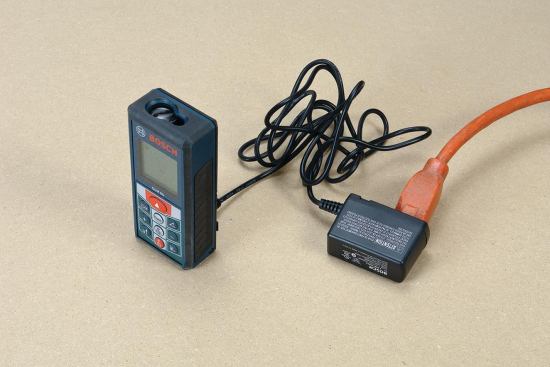

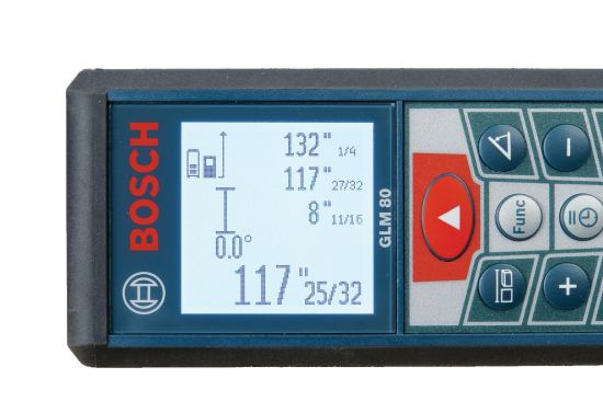

Bosch GLM 80

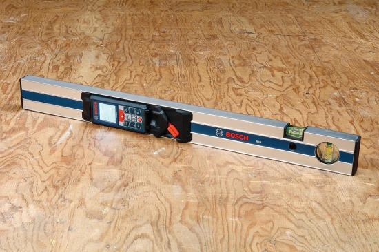

The rechargeable GLM 80 is the only model under $200 that has an inclinometer. It isn’t the most rugged model, but it displays fractions down to 1/32 inch, can handle direct and indirect measuring with ease, and has all the other perks I would want, from a timer to an erasable memory. For $250, you can buy a kit that includes Bosch’s R60 attachment, which quickly expands the meter into a 24-inch digital box-beam spirit level. I found that this combo isn’t as convenient as the advanced 24-inch Stabila electronic level I use (which has more helpful audio signals, for instance), but it was just as accurate after I quickly calibrated the inclinometer. The microsite at boschtools.com does a great job of demonstrating all of the GLM 80 features.

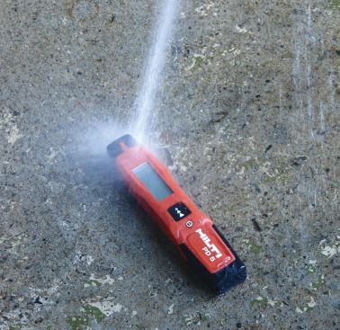

Hilti PD 5
This two-button laser is designed for installation work, period. It measures distances, has a tracking mode, and is long and slender so you can slip it into a narrow toolbelt pocket and grab it easily. You can also hose it off. But you have to press and hold the on/off button for two seconds to enter the menu and then manipulate both buttons to change the units of measure or control the beep, so it isn’t completely intuitive. Also, the display is upside-down when shooting from left to right. Several models have more features for less money, but Hilti has the only lifetime warranty.

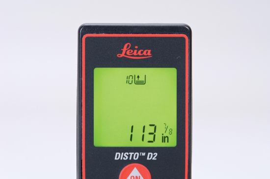

Leica Disto D2
The D2 offers all the critical measuring options you need for estimating and installing, plus deluxe amenities like a timer, a memory, and a tailpiece. It also fits into small pockets and feels just right in my hand. When it was introduced in 2008, it displayed fractions down to 1/32 inch; now it displays 16ths instead.

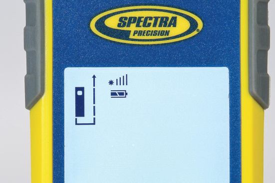

Spectra Precision QM55
The new QM55 offers the basic options you need for estimating or installing at a comparatively low price. It’s the first LDM I’ve seen that has a signal-strength indicator, which displays up to four bars to help you aim at an appropriate target. It also has the biggest memory, storing up to 50 measurements and calculations. According to Spectra, it’s drop-tested from 1.5 meters. On the downside, the tool is heavier than most, requires more button clicks, doesn’t have a timer, and makes you insert a separate tailpiece for measuring from inside corners. You also can’t turn off the beep, which may only be an issue for work in an occupied office or other quiet zone.

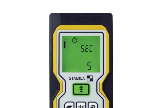

Stabila LD 400
Like the Milwaukee 2280-20, this model is fundamentally the same as the Leica Disto D2, adding a rubber bumper and extra buttons. But Stabila’s crowded keypad is the hardest of the three to navigate, and it gives no indication that the memory button also activates the timer. Last time I checked, the Stabila cost $70 more than the other two models.
Stanley TLM 165
Of the 13 models tested, only the Bosch GLM 50 costs less than the new TLM 165. The two models are similar, except the Bosch shows fractions down to 1/32 inch and has a tripod socket, while the Stanley has a small memory, a tailpiece, and a ghost-free display. Overall I prefer the Stanley, though I wish it displayed 32nds. Stanley’s manual, by the way, didn’t mention that you can turn the beep on and off by pressing the function and unit keys simultaneously for a second.

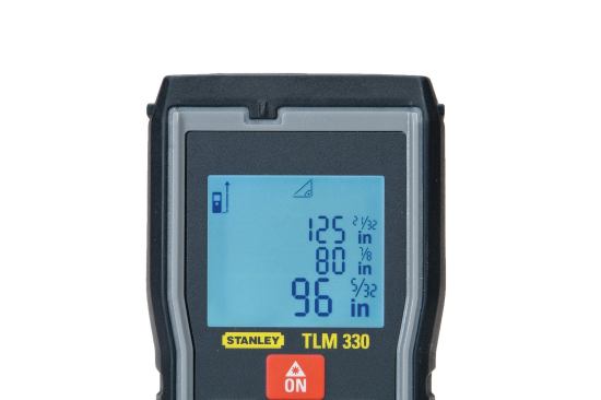

Stanley TLM 330
In the spec chart (pages 42 and 43), the new full-featured TLM 330 and Leica 7400x appear to be almost identical. But the Leica rates at IP65 rather than IP54 (which means you can hose it off), while the Stanley adds an extra Pythagoras function and a leveling mode that uses beeps to indicate level — handy if you can’t see the display. The Stanley also has four more keys for quicker access to several functions, but I think they clutter the keypad without significantly improving the tool. For instance, a new key makes it easier to calculate triangular areas (which I’ve never done), but you still need to use an obscure key combination to turn the backlight on and off. The Stanley currently costs about $15 less than the Leica, but comes with a two-year rather than a three-year warranty.

My overall favorite is the innovative Bosch GLM 80. It’s an especially quick estimator, easily measures indirectly, reads angles, has a bright rotating display, uses a rechargeable lithium-ion battery that delivers up to 25,000 measurements per charge, and is priced below the average. An optional attachment quickly converts it into a 2-foot electronic spirit level. The full-featured but pricier Leica 7400x and Stanley TLM 330 finished a close second.
