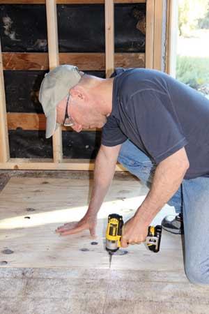

I put the drill/drivers and impact drivers through separate torture tests, which involved drilling thousands of holes and driving thousands of screws and lags into test planks (the "torture" was mostly to my elbows and wrists). The planks consisted of multiple layers of OSB glued together to create a substrate that was more uniform than framing lumber.
Drill/drivers. I tested the drill/drivers a couple of different ways, first by driving successively longer screws into the test planks and later by replicating the torque testing done in a lab.
The first test was very straightforward – the kind of thing a carpenter might do when trying out tools. I discovered that all of the tools could sink 3-1/2-inch coarse-thread and 4-inch fine-thread screws in low gear, but it was a struggle for the weakest of them. Shorter, 3-inch coarse-thread screws would be a comfortable maximum for any of these tools – the strongest of which can drive them in high gear, too.
Above: Manufacturers test to different standards, so in order to make apples-to-apples comparisons between brands, the author torque-tested the drill/drivers with an electronic torque tester. The results are listed under "PTI Torque" in the spec boxes starting on page 22. Right: To test runtime, the author drove screws and drilled holes into OSB test planks with the drill/drivers (top) and drove lags with the impact drivers (center). He tested speed of application by timing how long the impact drivers took to drive lags into test planks (bottom).
