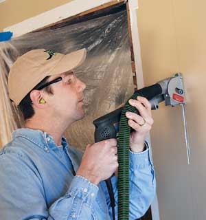

I first used the saw to widen a closet opening for a set of built-ins. The work was done in a fully furnished living room. After connecting the tool to an older Festool vacuum, I made about 12 feet of cuts through plaster-coated blue board. Within the first couple of feet I realized that the two hours I’d spent covering the floor and erecting a dust wall were completely unnecessary.
The KSV-432 cut quickly, and no dust escaped into the room from around the blade – except for a small amount during the initial plunge. I found the Kett to be more maneuverable than a circular saw, faster than an oscillating tool, and cleaner than a recip saw. The stellar dust collection greatly reduced my cleanup time.
The blade is covered by a housing and plunges into the work by means of a retractable spring-loaded shoe. This makes for better dust collection but means you can’t see the blade and must use a notch on the housing (like the one on a circular saw) as your guide. The foot plate’s hinge pin sticks out on both sides, so guiding the tool with a straightedge is not an option. If you’re careful, you can cut to within plus or minus 1/16 inch – good enough for semirough cuts where a slightly uneven line is not going to matter.
My favorite application for the vacuum saw is making inspection holes in drywall, a task I performed countless times as an employee in the service department of a high-end builder. The problem with inspection holes is that they must be made in a hurry in emergencies (if, say, there’s a plumbing or roof leak) – and often in finished spaces. Cutting access holes with the Kett saw was fast and painless; the time I would have spent on dust protection could be spent solving the problem at hand instead.
The vacuum saw is also handy for general demolition. I used it to take down drywall by cutting a dust-free 2-foot-by-2-foot grid pattern and simply pulling the pieces off by hand. It was as fast as other methods and a whole lot cleaner.
