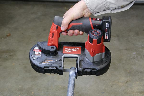

Earlier this year Milwaukee added a tool to its M12 line that I never expected to see: a cordless portable band saw. Many tool companies make 18-volt band saws, but this is the first subcompact (10.8-volt/12-volt max) model. At 6.75 pounds and 12 inches long, it’s small enough to be used one-handed.
The M12 saw is aimed at electricians, plumbers, and other trades that need to cut pipe, electrical conduit, threaded rod, angle-iron, and the like. It’s not supposed to do the job of larger corded and cordless (18-volt) band saws, though it can occasionally fill in for those machines. According to Milwaukee, the tool is best for someone who currently cuts metal with a hack saw or recip saw and wants to do the work faster and with less effort.
When the saw was announced, I asked the manufacturer to send me one — not because I was excited about there being another cordless band saw but because I couldn’t believe one this small could do anything useful. I quickly learned that it could. I also discovered that you find yourself cutting a lot more metal when you have a saw that does it so easily. Tasks I used to avoid because they were slow or unpleasant to do with a recip saw or grinder have moved up on my to-do list. I tried the tool out on scrap material, and used it to cut rebar for a patio project and bolts and angle-iron for various repairs.

The saw cuts faster than a recip saw and is easier to control. It has a variable-speed trigger and the blade goes 0–250 feet per minute (fpm). By way of comparison, Milwaukee’s 18-volt band saw tops out at 480 fpm, which is in line with what corded models can do. The manufacturer claims this saw can cut 3/4-inch EMT (electrical conduit) in as little as three seconds. I timed a few cuts and it took me about five seconds per cut.
The throat of the saw will accept material up to 1-5/8 inches wide and deep — though the tool works best on smaller material. I tried it on 15/8-inch Unistrut; it worked, but if I had to cut a lot of this material I’d prefer to have a bigger saw.
