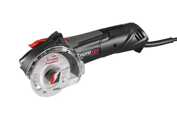

The kit (RFS1000) includes a 1-inch-diameter hose that connects the saw to the hose of a dust-collecting vacuum. One side of the guard is open so the blade can engage the work, and its face is removable for flush-cut applications. With the guard in place, the tool can cut about 3/4 inch deep. The rest of the tool is not all that different from a standard grinder, though it has less heft and power than the other grinders I own.

RotoZip makes five different blades for the saw: one ZipWheel and four XWheels. The ZipWheel – a dry diamond blade that cuts stone, masonry, porcelain, and tile – is flat and thicker than the XWheels. XWheels are domed, so the arbor nut is recessed below the face of the blade, which is why flush-cutting is possible. In addition to a dry diamond XWheel, there is one for wood, one for ferrous and nonferrous metal, and an all-around version for drywall, plastic, and nail-embedded wood.

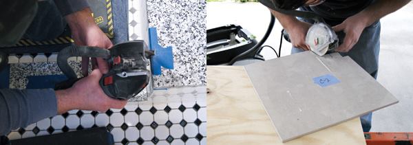

My remodeling company specializes in tile work, and we regularly use this saw to cut cement backerboard. In the past we used a grinder, and it created so much dust we had to wear masks and clear the air with a blower – even though we cut outdoors.
The job is easier with the ZipSaw. We still cut outdoors, because some of the dust escapes – but enough is collected that we can work without masks or a blower. The tool’s plastic hose could be better; it’s stiffer than I’d like, and more than once it’s come loose from the saw during a cut and sent a cloud of dust into the air. (It fits into the tool via friction.)

The ZipSaw can cut a variety of materials, but the author uses it primarily to cut cement board (left) and to make utility cuts in tile and stone (right). The work area stays relatively clean because the tool is equipped for dust collection and can be connected by hose to a vacuum.

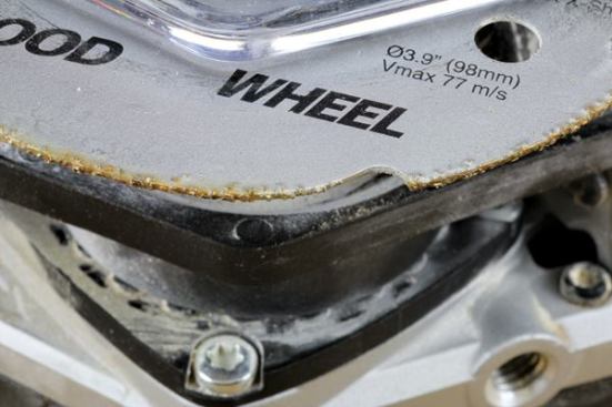

The ZipSaw can cut wood, but we prefer not to use it for that task: The wood blade has no real teeth and cuts by abrasion. The tool would cut more cleanly with a toothed blade, and then you wouldn’t get that burning smell from grinding wood.

The blades cut by abrasion – even the wood blade, which has no real teeth and has a carbide grit coating along its edge.
