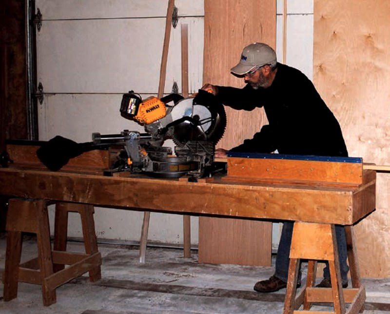

The miter-saw stand sits on a pair of mini-sawhorses and has
three basic parts: a platform for the saw to sit on, left and right
wings for supporting the workpiece, and a fence for the work to
sit against.
The miter-saw stand sits on a pair of mini-sawhorses and has three basic parts: a platform for the saw to sit on, left and right wings for supporting the workpiece, and a fence for the work to sit against.
The two tools our crew uses the most for finish work are a miter saw and a table saw. To make the best use of them, we built a couple of custom stands. Both are made primarily from 3/4-inch plywood and incorporate clamping and measuring products from Kreg Tool Co. The Kreg products help maximize the efficiency and accuracy of the tools, and the plywood construction makes the stands sturdy enough for everyday use, either in the shop or on the jobsite. And both stands are light enough for two crew members to carry easily.
Miter-Saw Stand
The miter-saw stand sits on a pair of mini-sawhorses and has three basic parts: a platform for the saw to sit on, left and right wings for supporting the workpiece, and a fence for the work to sit against. I’m able to rip everything out of a sheet and a half of plywood; I can usually round up a few plywood scraps from the shop or on the jobsite, so I buy just one sheet to build a stand.
Platform. To build the platform, I first make a 23 7/8-inch-wide rip for the top and then rip two sides 5 7/8 inches wide. The top and sides are the full length of the plywood sheet. For the crossmembers, or gussets, I cut five 5 7/8-inch-by-22 3/8-inch rectangular pieces out of my scraps.
I drill three pocket-screw holes in the ends of each crossmember, along with holes every 6 to 8 inches along the edges of the 8-foot sides. The crossmembers screw to the sides at 2 feet on-center to make a frame that forms the backbone of the platform. To complete the platform, I pocket-screw the sides of the frame to the top.
Support wings. The stand you build has to be customized to fit the particular brand and model of saw that you own. For it to work for your saw, the most critical part of making the support wings is taking a dead-accurate measurement of your miter saw’s bed height and then building the support wings to a matching height. For the wings, I make two frames similar to the platform. The sides and gussets for the wings are the height of the miter-saw base minus two thicknesses of plywood.
To figure the length of the support wings, I place the miter saw squarely on the platform and rotate the saw table to the maximum cutting angle on both sides. This gives me how much clearance I’ll need—and I make sure to add plenty of room for my fingers.

For the depth of the wings, I measure from the front of the platform to about 1/2 inch behind the saw fence (I’ll explain why I measure to this point later, when I describe the fences). I nail the wing frames together with 1 1/2-inch 18-gauge brads and then pocket-screw the wings to the platform flush with the ends and the front edge.
To attach the fences, I pocket-screw them to the platform, as well as screwing them to the backs of the wings.
Fences and tracks. I make the fences out of the same 3/4-inch plywood, about 6 inches tall and the same length as the wing frames. To attach the fences, I pocket-screw them to the platform, as well as screwing them to the backs of the wings.
