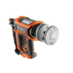

You can tell from the exploded view that like a pneumatic, the gun has a cylinder and piston.
Ridgid has just released a pair of 18-volt Hyperdrive cordless nailers, an 18-gauge brad gun (R09890B) and a 16-gauge straight finish nailer (R09892B). The tools use compressed air to power the driver so the nailing experience is akin to that of a pneumatic. The technology is similar to that of the Ryobi Airstrike guns; a motor compresses the air behind the driver assembly (driver, piston, and O-rings) by pushing it towards the top of the cylinder. Once there, the piston is held in place by a magnet. Squeezing the trigger releases the magnet and the driver comes down, driving the nail with the kind of pop you get from a pneumatic. At the end of the drive the motor raises the driver assembly back to the starting position.
Ridgid’s hand-held power tools (including the Hyperdrive) are produced by TTi, which owns Milwaukee and Ryobi. I asked a TTi spokesman how the new Ridgid guns compare to Ryobi’s and was told they contain a beefier version of the same mechanism. You can tell by looking that the tools are related. Both brands have a lever at the back to edge of the housing that is used to adjust the power of drive. It does this by changing the holding power of the magnet. Less holding power means the air is compressed less as the driver and piston are “cocked” against it. More holding power means the air is under more pressure, so the driver has more energy behind it.
