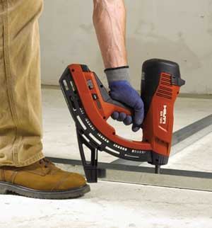

The Hilti GX120 is the clear winner for the gas-tools category, outranking the competition by far in both performance and features. It is truly the most advanced tool in the class, with design improvements in virtually every aspect of its operation. The other tools were fairly close in performance, with the Simpson tool taking second place and the Powers C3 third. If we had to pick a fourth, the Ramset TF1100 would just edge out the Hitachi model, mostly because its fuel and fasteners are compatible with the previous two market-leading tools. The Ramset T3 worked fine on track, but its one-inch maximum pin size limits its versatility. And the extra-large Powers C4 is too big to use for just shooting track, but it’s the only gas tool that can shoot into 2-bys.

The leg at the rear of the strip-magazine tools serves two purposes. First, because its height is level with the pinner’s nose, it can be used to help guide the pin in at a 90-degree angle instead of at a dangerous glancing angle. And second, it supports the weight of the tool – and, during firing, a lot of the user’s weight.
Since these tools are most often used for shooting into the floor, they are typically dragged instead of lifted from shot to shot – usually spaced 16 to 24 inches. To keep the tool from skating away if your reach is not straight down, it helps to have a grippy point of contact against the smooth steel track or concrete. The gas Hilti pinner (center right) has a soft rubber foot that provides superb traction. The Hitachi has a soft plastic nose cap designed to achieve the same thing, but the tool isn’t as sure-footed. This nose cap also reduces the depth of drive a bit, which may interfere with fastener penetration in tough applications.

The gas Hilti (below right) trumps them all with a nosepiece that drops out with the push of a button and a magazine that pulls out with the flip of a lever.
