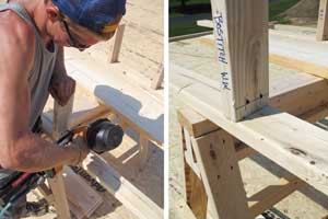

Toenailing
How well a gun toenails depends on how effectively the teeth on the tip engage the wood and whether you can place nails accurately. We got a sense of this from using the tools and from performing a test in which we marked the ends of some 2x4s and tried to hit those marks while toenailing. All of the tips grab pretty well; the ones where the teeth flare out grab the best. I particularly like toenailing with the Bosch, because the fine teeth really grab and the slimmer-than-normal piston housing provides a good line of sight to the tip (though it takes some practice to place the fastener where you want it). The Paslode is very good at toenailing, but the DeWalt and Senco are less so, because they don’t grab as well. The Ridgid gun has poor visibility and tends to leave nails proud when toenailing.

To test the nosepieces, the crew marked short studs and then used the nailers to toenail them (left) to a plate. The best guns gripped well and placed the nails close to the original marks.

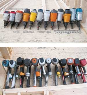

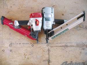

Size is as important as weight, though it’s harder to define because there are so many dimensions to consider. When I say a gun is compact,
I am referring primarily to its top-to-bottom height, because that dimension determines the ease with which it can be used sideways in narrow framing bays. The Max and Senco are significantly shorter than average. Their short stature makes them look wider in front, but it didn’t affect our line of sight.

Makers like Max and Senco have shortened some of their guns to make them easier to maneuver in narrow framing cavities; you can see the difference in size in the top photo (the Max gun is on the left). The author lined up all the tools to get a sense of their relative bulk. Viewed from the front (below) from left to right are the Max, Senco, Paslode, Bostitch F33PT, DeWalt, Bosch, Grip-Rite, Ridgid, Porter-Cable, Bostitch F28WW, Hitachi, and Makita. Viewed from the back (very bottom), the order is reversed.
