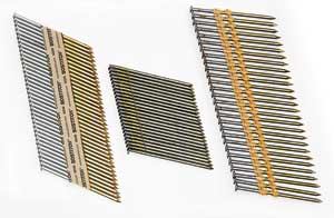

Most manufacturers produce two versions of every gun – one for 30- to 34-degree nails (usually clipped-head) and another for 20- to 22-degree nails (usually full round-head). Here in western New York, 30- to 34-degree paper-collated nails are the norm, so that’s the kind of gun we tested. (The one exception is the Bostitch F28WW, which takes 28-degree wire-collated nails.) The equivalent models for 20- to 22-degree plastic-collated fasteners are listed in the spec chart (magazine page 22).

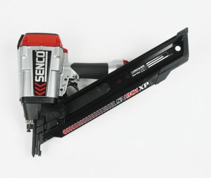

I wouldn’t draw too many conclusions from this test or make fine distinctions based on a difference of two or three nails per round; we tested the tools on the job site, which is different from testing them in a lab under carefully controlled conditions. What I can say, however, is that the finishing order was not a surprise. Based on having used the guns in the field, we thought the Paslode and Bosch would come in near the top and the Senco and Ridgid near the bottom – which is exactly what happened. In fairness to Senco, we tested the company’s lightest gun; the results might have been different had we tested the heavier and more powerful SN951XP.
Most of the guns in this test take 30- to 34-degree paper-collated fasteners (far left), though one takes 28-degree wire-weld fasteners (center left). Slightly different versions of the guns are available for use with 20- to 22-degree plastic collated fasteners (left), which are common in areas where wind and seismic codes mandate the use of full round-head nails.
